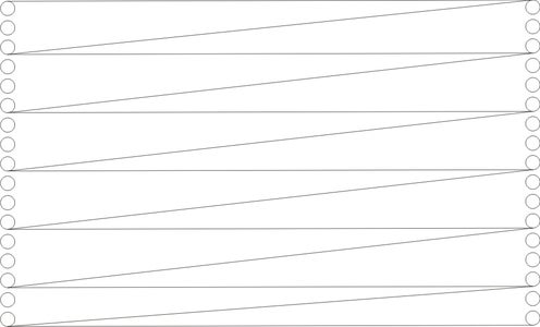

Step 1: Design
The Corel Draw file below contains a simple yet effective toothpick design. The sides are perforated so that the toothpicks stay in place until you need them, then all you simply have to do is pop them out.
I laser cut the design into the plastic card, but that's obviously not always an option. If you're feeling inspired, you can simply print and copy the pattern onto the card and cut on the lines using an exacto knife to create the card yourself by hand.
