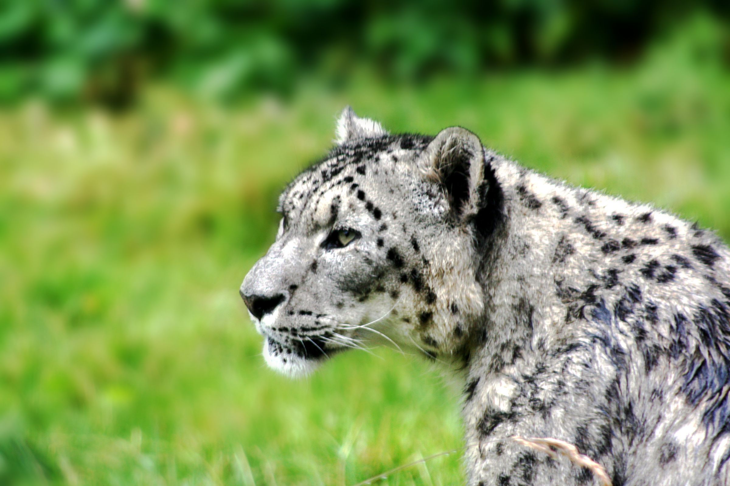

Step 2: Lion and Flip
A brilliant image that I found, unfortunately even using similar image search I couldn't find the origin to give credit.
I also flipped it using
Image>Image_Rotation>Flip_canvas_Horizontal.
This is purely beacuse I thought it would look better the other way on the apple. I felt it would just flow more, flipping the final image now I can see I was right. But you can always experiment in the first half of the next step.
