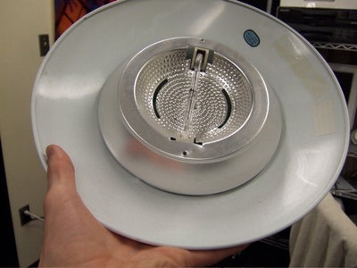

Remove the halogen bulb and the metal heat shield. Cut the two wires close to the bulb holder. Tug on them gently to obtain a little more length. You now have what I call "bulb holder pigtails".
