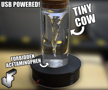

This is a USB powered lamp that uses magnets attached to a 5V motor to stir water. It has an illuminated, 3D printed base and a tiny cow suspended from the cork.

If you haven't already, print the cow from the Thingiverse link. I printed mine 15mm long. Painstakingly paint the cow, and finish with a thin UV resin layer. Drill a hole in the cow and attach to fishing swivel with monofilament line. Drill a hole in the cork lid for the swivel to sit in. I held mine in place with a staple.
Step 9: Finished!
Let's take this bad boy for a spin! Drop in your stir bar, fill with water, and cap. Don't forget to name your cow.
