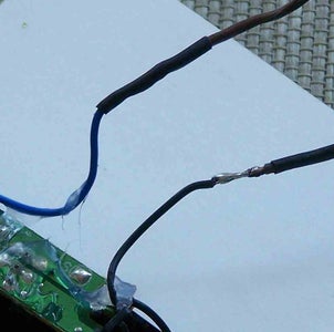

Step 7: Splice (connect) the Low Voltage Extension Wires
Connect the wires again being careful with the small leads. Do not worry if your stranded low voltage electric wires is a slightly thicker gauge than the leads from each component. The several individual wires in stranded wire is flexible and that is why you want to use stranded wire instead of single wire.
If you are using light gauge speaker wire as I did, one of the exposed stranded wires will be silver in color, and the other copper. You have to make sure you connect the black lead on the LED assembly to the black lead of the solar cell. Same for the blue leads. Your colors may vary. but one is very likely to be black. You will be making a total of four splices. Two at the LED assembly and two at the solar cell.
You can simply twist one of the extension wires to one of the leads and then wrap electrical tape. However, I preferred to solder the connections using "Western Union" splices taught to me by my eighth grade electric shop teacher.
In the photo, I have shown the blue splice with the heat shrink tubing fitted, and the black lead soldered with the tubing ready to be moved onto the splice and shrunk.
