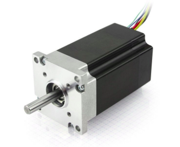

An example on how to handle Torque control of a Brushless Motor with Hall Sensors using Arduino UNO, a Brushless DC Motor with the part number of “DB56C036030-A” from Nanotech and Solo UNO as motor controller. To make it work, I also use the Library for communication between Arduino and Solo, more info here.
The idea of this example is to lock the shaft of the motor by hand and by code increase the torque of the motor gradually in order to feel how the force is increasing every time.
