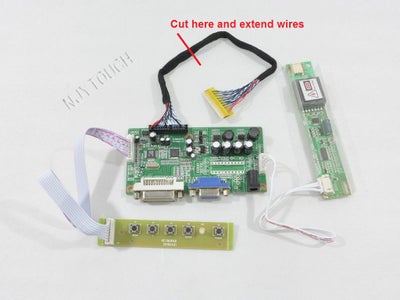

- 5451 DVI LCD Controller VGA DIY 1920x1200 logic Board AD Converter

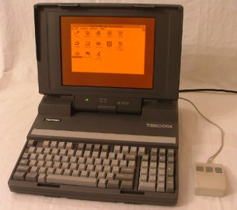

The first thing you need to do is find a vintage laptop somewhere on eBay. I just so happen to have an old 1989 Toshiba T3200SX that I got from a friend. These are very good for this type of project because they have ton a space inside to put all your new hardware in. My friend purchases this vintage PC from Goodwill for about $20 but they can often go for about $200-$300 on eBay.

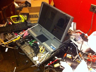

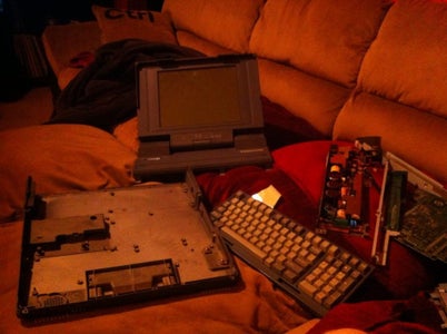

Step 3: Strip the Inside of the Toshiba T3200
Now, you need to completely strip the T3200 laptop down to its bare bones. Everything most go! The only thing you want left is the outer case. Get rid of the motherboard, hard drive, power supply, plasma screen, and keyboard.
I even suggest taking a dremel tool and cutting off all the tiny brass bolts that are embedded into the case. If you don't have a dremel tool, get one, it will be your best friend in this project.

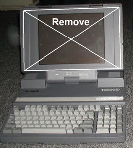

Step 4: Remove the Monitor

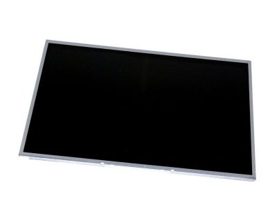

When removing the monitor, just get rid of the old plasma screen that was in it because you are going to upgrade it to a 15.4" Laptop LCD Screen.

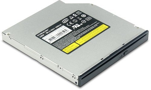

Step 7: First: Optical Drive
For my optical drive I used a Blu-ray slot type drive. I have it facing out the rear of the case and mounted it the case using hot glue and/or double sided 3M tape. Don't forget to hook up the cables to it because you will be mounting the motherboard right on top of it.

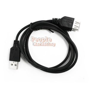

Before we put the motherboard in, start installing all your cables. I used a 1 foot HDMI cable and mounted it beside the optical drive so I could have an output if needed in the future. Next, I ran the headphone and mic jacks out the right hand side. There were already holes there from old ports before that I used. After that, I used about 5 USB extension cables and ran them horizontal through the mouth of the old 3.5" floppy drive, the I used the floppy drives eject button as the new power switch, and then I removed the old floppy drive LED light and pushed the reset button out though the light hole (I know, super creative, right). I used lots of hot glue to hold it all together.

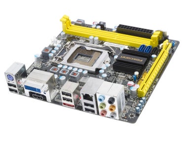

Step 9: Third: Motherboard
Now, we need to mount the motherboard. The motherboard needs to get stacked right on top of the optical drive. Use Motherboard Standoffs to secure the board to the case. This will take a little bit of playing around with to get right. To ensure that the bottom of the motherboard never touches the metal case of the optical drive, I cut a piece of sheet metal the same size as the motherboard and sprayed it with rubber stray paint called PlastiDip. After that I drilled 4 holes in the 4 corners and screwed it into place. I put a motherboard standoff in between the board and plate as a spacer. Then those standoffs screwed into the standoffs attached to the case housing.

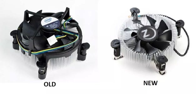

You will most likely need to buy a lower profile heatsink for the processor because the one it comes with sits just a little too high to close the case once it's all done.

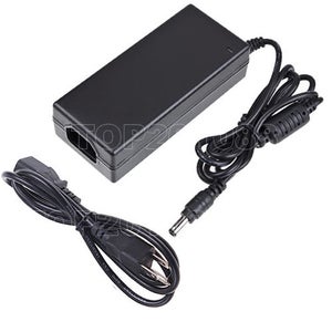

The power supply that comes with this motherboard is large. So you will need to tear it completely down and get rid of its external plastic and internal coverings. Also, every inch counts inside this small case, which means once you have the power supply naked and secured using the motherboard standoffs inside the case, cut off the extra cord and only make it as long as you need it to be, and wire it back together with wire nuts and electrically tape.

Step 12: Sixth: LCD Monitor
Now, it order to do this, you will either have to use a dremel tool to cut the front hole bigger or do what I did and had it water jetted. It comes out perfect. See picture above.
The 15.4" LCD Screen will fit perfectly inside the case once you use your dremel tool to cut out all the extra plastic that gets in the way. Remember, this is an art... not a exact science. You'll have to think on your own for a lot of this project. After it fits inside, hot glue it into place. The two clips on the top will also need to trimmed and modified in order to fit correctly. There are two springs inside each clip, cut the spring in half and hot glue them right on top of the LCD screen so they doesn't fall out.
After that, I put some blue LED light strips behind the screen so they glow out the rear vents. If you want to do this step, remember to take black electrical tape and completely cover the back of the LCD screen. The reason is because the blue light will glow right through the LCD screen if you don't. This next part is a little tricky. You can't exactly plug an LCD screen from a laptop into a desktop computer. It need power and a video cable. You will need to order a LCD Controller. There is a guy on eBay who sells these for about $35. They are awesome! I put the link below. With this controller you will need a power supply and a 1 foot VGA cable to power the screen and hook up the video feed to the motherboard.
http://www.ebay.com/itm/5451-DVI-LCD-Controller-VGA-DIY-1920x1200-Logic-Board-AD-Converter-LVDS-xBox-PC-/271509452577
The LCD Controller will sit inside the main body on the case with the power supply for the screen (strip that power supply down too and get rid of its outer plastic case). You will have to run the cables up through the screen housing to connect everything. One note, the cable the gets plugged into the LCD that controls the video input might be slightly too short like it was in my case. So, what I did is cut each little wire within the cable and extended it about 4" using wires from an old Ethernet cable (see picture above). Once all the cable are hooked up inside the screen housing, tape it all down to the back of the LCD screen with black electrical tape. After that, if you want, you can run your Power, HDD, and Reset LED lights inside the screen housing too. The lights are all ready there from the old computer. You can either tap into the old ones or replace them with new LEDs. After you get them in place, you can run them out the bottom of the screen housing along with the rest of the cables and plug them into the motherboard once it's mounted.

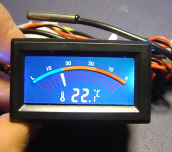

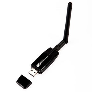

There are a few more additional parts you might want to add. Such as the LCD Digital Thermometer and a 300Mbps 11n Wireless WiFi USB Adapter.
In addition, study the pictures here to see where I placed all the wires, power supplies, etc.
