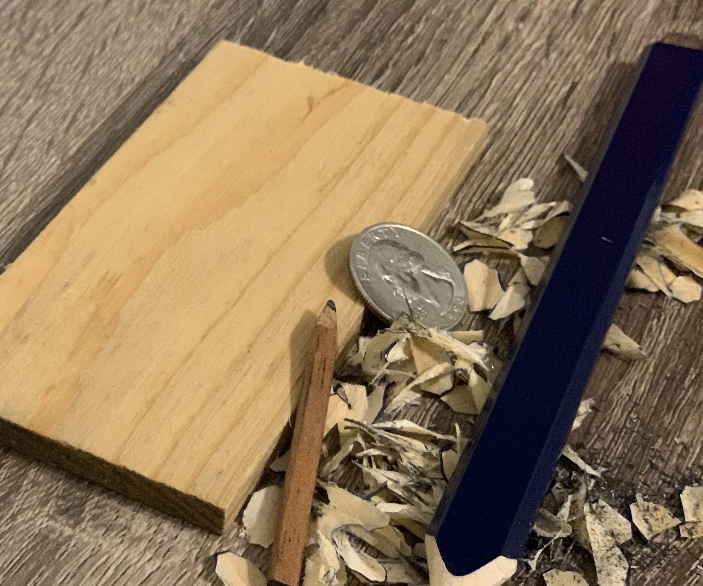

Screw one of the nuts on to the machine-bolt-type end of the hanger bolt as far as you can. Then use the nut and your wrench to drive the wood-screw end of the hanger bolt into your dowel. If the depth is correct, you should be able to drive the hanger bolt in until the nut hits the top of the dowel.
Use a penny to drive your threaded insert into the other end.
(The hole I made for the threaded insert was actually too wide so I ended up gluing it in with some gorilla glue, just make sure you keep the threads clean and that it dries completely before you try to put it onto the tripod base.)
