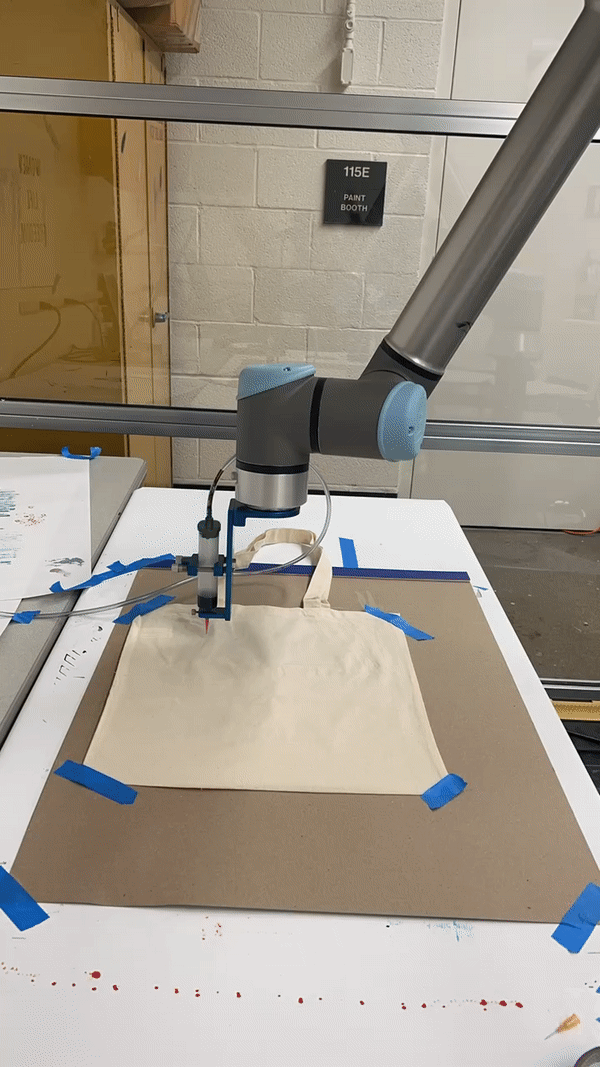

Today we'll be teaching you how to paint artwork on a tote bag using a robotic arm.
-Industrial Robot Arm, UR-10E model
-Rhino & Grasshopper Desktop Software
-Mondo Llama Multi-surface paint
-Dispensing Kit that fits into robotic arm attachment

We brought the line drawing into Grasshopper and then lined it up with our tote bag to center the abstract face. This is where we control the robotic arm and dispenser.

We did a few test runs to see how the dispenser and it's pressure interacted with our material and the surface. The paint hardens over time but as it comes out of the dispenser, it's the same consistency as acrylic paint. Our initial pressure setting was too high, pushing out the material into one blob. After adjusting and turning the pressurizer down in it's setting, we were able to draw as a straight line, much more alike our image.

We first started out with one color to draw the face, filling up the syringe with paint about half an inch high. Then we moved the tote to the right to create a more interesting, 3D like design with another color. In between colors we rinsed the syringe fully to clear out the first color. Make sure when you are done, to fully rinse the syringe to get all the leftover residue out for the next user. Soaking the needle tip in acetone is another helpful cleaning tool to get everything sanitized.
