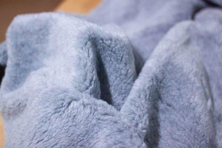

The finished Totoro handbag is about 28 x 19 x 4 cm/11 x 7.5 x 1.6 in and you can use a variety of materials. Totoro is a gentle fluffy giant so the most authentic will be fluffy fabrics with long or curly hair. I used this faux fur non-elastic fabric and white and black felt for the smaller pieces, it contrasts nicely with the long hair.

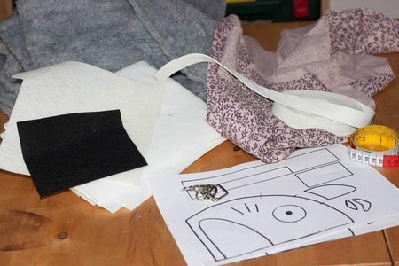

  1. pattern: A4, US Letter – see more below
  2. approx. 0,5 m/yd of main fabric in grey color
  3. approx. 0,5 m/yd of lining – non-elastic, for example, cotton canvas.
  4. max. 0,5 m/yd fusible interfacing
  5. cca 30 x 30 cm/12 x 12 in of white felt
  6. piece of black felt
  7. 2 D/rings of 2 cm/0.8 in
  8. 1 slider of 2 cm/0.8 in
  9. 150 cm/60 in of shoulder strap, width 0.8 in
  10. 30 cm/11.5 – 12 in zipper
  11. sewing machine, thread, needles
  12. pins
  13. optional: Stylefix or other double-sided tape

Step 1: Cutting
Here’s a list of the parts:
Head
  1. Cut 2 on fold from main fabric, lining and interfacing.
  2. Add 1 cm/0.4 in seam allowance to main fabric and lining.
Belly
  1. Cut 1 on fold from white felt, don’t add seam allowance.
Eye
  1. Cut 2 from white felt, don’t add seam allowance.
Pupil
  1. Cut 2 from black felt, don’t add seam allowance.
Center stripe
  1. Cut 1 on fold from main fabric, lining and interfacing.
Zipper side
D-ring loop
  1. Cut 2 from main fabric, don’t add seam allowance.
Ear
  1. Cut 2 mirroring pairs from main fabric, add 1 cm/0.4 in seam allowance.
  2. Cut 2 mirroring pairs from interfacing.
Fur
  1. Cut 3 from main fabric, don’t add seam allowance.
Nose
  1. Cut from black felt.

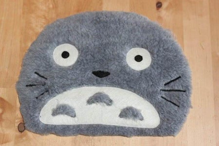

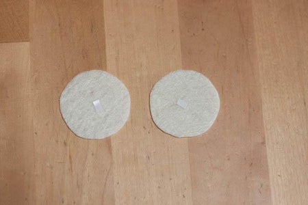

Prepare the two eye pieces and pupils, you’ll be stitching them together and to the front of the bag. Put a little Stylefix tape in the center of each eye and attach the pupils to it so they don’t move when you stitch them.
Topstitch the pupils around the edge.

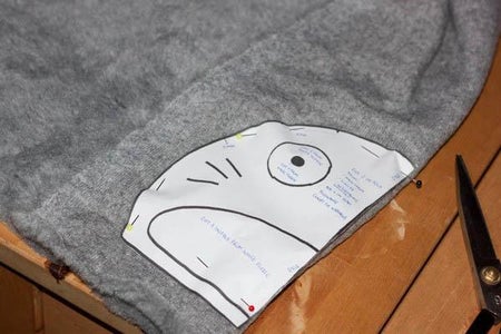

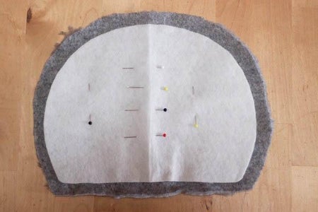

Open one of your head pieces and place the pattern on it respecting the seam allowance. This will help you place the face pieces. Start with the nose, it will create the center and help you place the eyes. You can attach the nose with Stylefix as well. Topstitch around the edges.
If you’re using furry main fabric, some of the hair will get caught in the stitches. Use a pin to gently pull the hair out of the stitches.
Now you have the nose topstitched to the head.
Put the pattern back on the head and place one eye. Attach with tape and topstitch around the edge.
Do the same with the other eye.
Step 3:

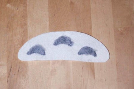

Topstitch the 3 fur pieces to the belly part.

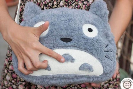

Place the belly on the front, center it nicely and topstitch.
Embroider whiskers with a zigzag stitch.

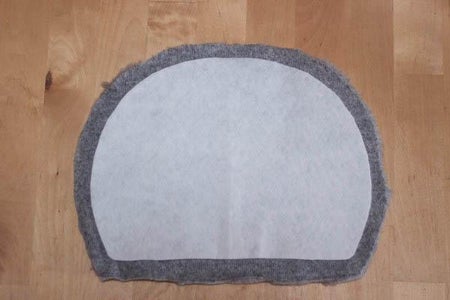

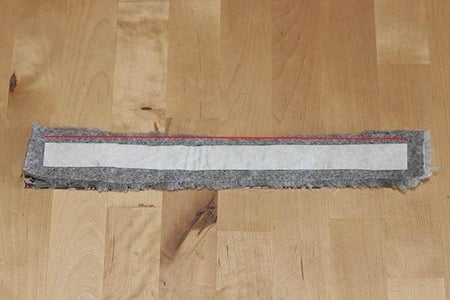

Step 4: Interfacing
Now you can iron the interfacing onto the wring side of both headpieces.
You can also iron on the interfacing to the remaining pieces that require it – ears, center stripe and zipper sides. You’ll be needing them in the next steps.

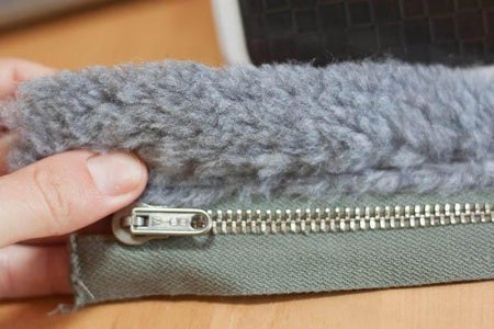

Step 6: Zipper
Place one lining zipper face right side up.
Place the zipper on it upside up. The lining piece should be a little longer on each side. It doesn’t matter which side you’ll stitch first align one long side of the lining with one long side of the zipper. I recommend attaching these sides first with Stylefix.
Now place one main fabric zipper side wrong side up on the zipper, aligning it with the side you’re stitching, use Stylefix also here or you can use pins.
Now stitch that side leaving about 1 cm/0.4 in on each side not stitched. Use a zipper foot on your machine. I don’t stitch as close to the zipper as I could because I want the fur to be a bit further, there will be less change of it getting caught in the zipper.
Turn both lining and main fabric piece away from the zipper so you can see the zipper.
Topstitch 0,5 cm/0.2 in from the inner edge.

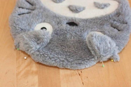

Step 7: Ears
Place two mirroring ear pieces right sides together and stitch 1 cm/0.4 in from the edge. Leave the bottom side open.
Turn the ears right side out through the opening.
Also here, don’t forget to gently pull out the hair that got caught in the stitches.
Pin the ears inside the marks for ears on the patter. The ears have to be lying on the head piece.
Stitch them 0,5 cm/0.4 in from the edge.

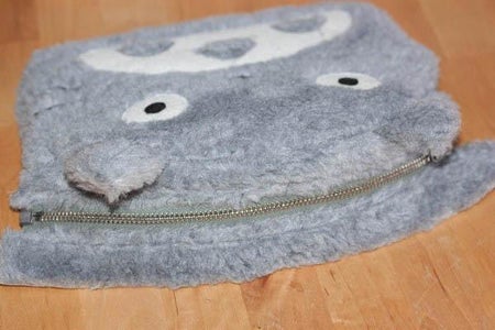

Step 8: Assembling the Outside of the Bag

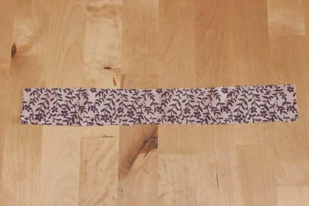

Make small cuts along both long sides of the main fabric of the zipper piece (you can do the same for the lining or do it later). The cuts have to be only about 2 mm/0.08 in. Make them every 1,5 – 2,5 cm/0.6 – 1 in. These cuts will help attach the straight side of the zipper piece to the round side of the main bag piece. Use the zipper marks from the pattern and place the zipper piece between them. The zipper piece is actually a little longer and about 1 cm/0.4 in of the zipper piece will go beyond the zipper mark.
Pin the main fabric of the zipper piece to one of the head pieces from main fabric (I started with the face), fold the lining of the zipper piece back so you don’t accidentally stitch it. Stitch the pinned side within the seam allowance but leave the 1 cm/0.4 in on each side unstitched.

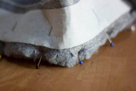

Next you’ll be attaching the center piece to the bottom of the head piece. Make the same small cuts on the long sides of the center piece. Pin between the zipper marks and even here you should have some extra length of the center piece on each side, so leave this unstitched.
You’ll later sew this extra length to the extra length of the zipper piece.

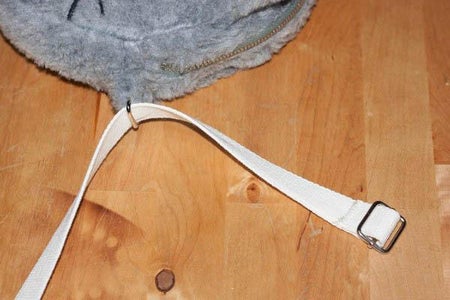

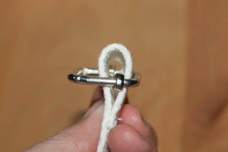

Pull one end of the strap around the center of the slider.
Topstitch right at the slider.
Pull the other end of the strap through one of the D-rings.
And back through the slider from one side to the other.
Pull it through.
And then through the other D-ring and stitch right at the D-ring.
Your Totoro handbag is done and ready to be worn!
