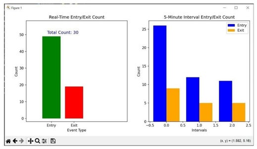

The Touch-less Entry-Exit Data Tracking System (TEED-TS) is a hygienic, non-contact solution designed to monitor entry and exit movements. It uses Infrared (IR) sensors, the ESP8266 micro-controller, and IoT technologies to provide real-time data tracking while reducing physical contact.

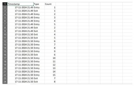

Collected data is visualized through dynamic graphs and stored in CSV format, making it suitable for environments requiring reliable monitoring, and data collection for marketing campaigns and for other uses such as:

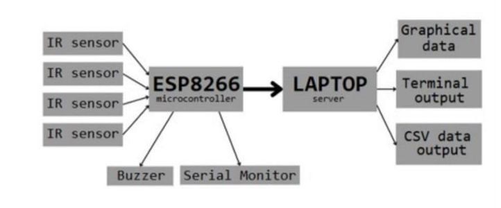

All the 4 sensors at a place can be directly driven by the micro controller itself due to the lower power consumption.
  1. connect all the positive and negative of the sensors to the micro controllers positive and negative terminal
  2. connect the signal wires of the IR sensor to an AND gate and then connect the O/P of the AND gates to the pins 4 and 5 of the ESP8266 respectively as mentioned in the source code for the micro controller

The Arduino boots up , then connect to internet to retrieve the correct time info , then when entry or exit is detected , it will send the data to the host machine through serial communication and the python script scrapes the needed info such as time and entry/exit and update on log and make graphs in real-time
Step 4: Data and Control Flow
The above image shows the data and control flow of the data between the client and host
