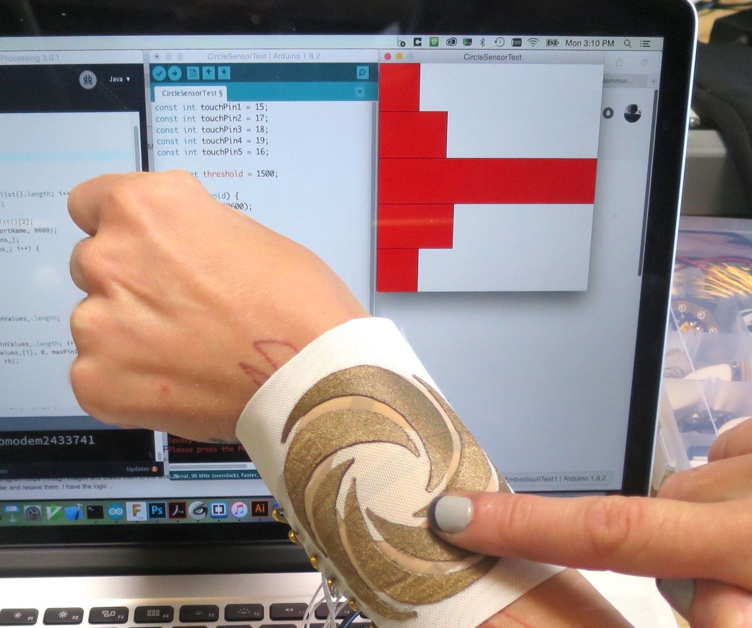

- This Instructable will show you how to make a touch-sensitive musical painting with a Teensy to send MIDI to a Mac Mini that synthesizes sounds with Ableton Live. The painting itself is made with acrylic paint, conductive paint, colored pencil, and nails on a wood panel.
- To get an overview of how to do capacitive touch sensing in general, check out this Instructable.
- This technique can be easily applied to other materials and touch sensing applications!

Step 4: Paint the Conductive Shapes
After your painting is fully dry, use the conductive paint to paint your touch sensitive shapes on top. Remember these shapes shouldn't touch. Paint somewhat thickly, and avoid watering down the conductive paint. You can mix in a little water with some conductive paint on a palette if you are struggling to paint tiny details or clean edges and need it to flow a bit more. Let the painting dry completely.
Warning: If you attempt to mix colored paint with the conductive paint to make new colors, your shapes may no longer be conductive enough for touch sensing. It's best to keep the paint as pure as possible.
Step 5: Connect Conductive Shapes to Back of Painting
We wanted this to be very sturdy because we put it in a public space and it gets a lot of use, so we hammered regular nails through each conductive shape. You can touch the shape anywhere, not just on the nail head, to produce sound. The nails create a solid connection between the conductive shapes and the electronics on the back of the painting. I painted over some of the nail heads with more conductive paint for visual interest, but this is not needed for functionality.
Tip: You don't necessarily have to have one shape per sound. On the back of the painting you can wire multiple shapes to play the same sound. This simplifies the electronics while allowing you to create a more complex composition.
Step 6: Wire the Conductive Shapes
Connect the nails to the inputs on your board/s. We used a mixture of soldered wires and copper tape. If your painting is complex, it is helpful to label all the nails with a pencil on the back. Keep in mind how many inputs you have available on your board/s. We often connected multiple shapes together to the same input to reduce the number of inputs we needed.
