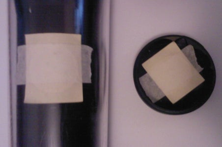

Let's start things with the easy part. Peel off touchatags and stick one under your mug, and one on the side of mug - if you're very rich ! If you're not, make the tags removable (using bluetac for example). As you can see in the pictures, I cheat by using one of my favourite Starbucks insert tumbler (and yes, I already know I drink too much coffee a day) : it's easy to tape a tag to the inside of the insert, or under the bottom screw-on cap, and to remove both before a dive in the dishwasher.
Done ? To the next step !

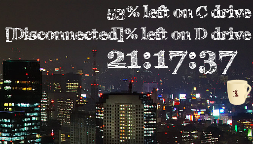

Having a text file which displays how many times you've been drinking coffee until you reset it, but it's not super-interesting if you have to click it open all the time. That's where Samurize comes into play, with its ability to refresh files regularly and display their content : we're going to use it to display the content of the coffeerize.txt file on the desktop following the method you can find in the awesome tutorial over at Samurize.com's.
Since Samurize gives you many options in customization, you also get to display the counter on top of an image - I'm using a coffee mug sketched by Christina Smith from 5sizes2small Studios for decoration !
And now on to the last step.
