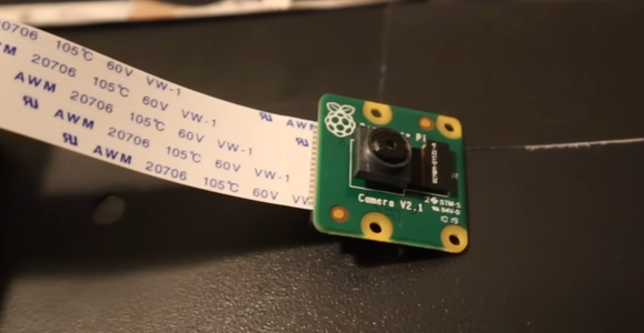

Raspberry Pi Camera Module: https://amzn.to/3b6Eja1

Add a LED strip to the back of a monitor (we will program this to light up when the face detection is accepted) place the Raspberry Pi in the case if you have one and then connect the camera module to it.
