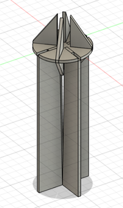

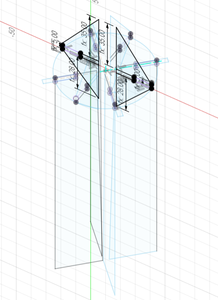

Step 2: Fusion 360
When I started to put it into Fusion 360, I initiated it with the circular top piece. This is where I had designed all the press fits into it. It is design with 4 legs, which all slight expand inwards as the reach the bottom. The press fit for the legs has no upper stabilization, allowing for a flat top area. I had added 4 upper shapes, which are press fit normally into the circular top piece. All the pieces are parameterized. I had thought of adding an "antenna", but decided it didn't look good after designing it in, so I took it out.

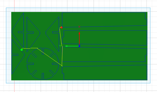

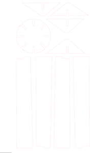

Step 3: Adobe + Laser Cutting
I had imported the fusion design into Adobe Illustrator and marked all the lines red for cutting. The laser cutting took about 1 minute and 30 seconds, with little hassle. All pieces came out intact and correctly.
Step 4: Outcome
Thee outcome was good, It all came together. Although the press fits were very tight and required a good amount of force to get in. I believe I may have adjusted the model a little when putting it into the laser cutting software.
