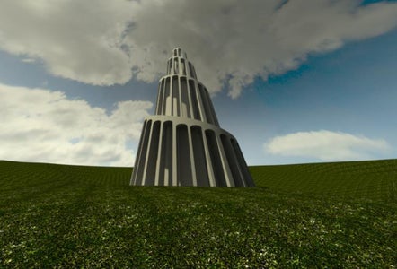

Step 1: Research
The actual shape of the Tower of Babel has always been speculated as there was never any conformation on how it actually looked. Many people think it was a Ziggurat that kept climbing upwards however, I believe it to be a spiral shaped like a tower. Though we may never know what it actually appeared as this is my personal rendition of what it could've been.
Step 2: Creating the Tower
To start this project, the first thing that you'll need to do is use model lines to create a spiral tapering inward.
  1. Once you have the spiral, you will need to use the "Model in-place" component feature and scroll to "Walls"
  2. Then use the "Swept Blend" tool to pick the interior interior model line to create a sketch on
  3. Edit profile #1 to create a rectangle sketch that isn't too high
  4. Edit profile #2 to make it about 6' higher than the previous profile then Finish the sketch.
  5. Continue the steps until you get to the piece of the interior spiral
Step 3: Top of the Tower
When getting to the top of the tower, start it like the previous sloped ramp however when getting to the second profile, you're going to keep it at the same height as the top of the previous ramp.
  1. To make the middle first select Extrusion and not Swept blend
  2. Set a work plane to the flat part of the ramp
  3. Use the select lines tool to select the edge of the rectangle and interior semi-circle
  4. Draw an arch from the left point to the right point
  5. Finish the sketch then drag the extrusion to the ground
  6. Now the main part of the Tower of Babel is complete
Step 4: Adding the Openings
To add the Arches, you will need to use the pre-made Archway component.
  1. After you select the component, edit the type
  2. Duplicate the type and edit the height of the arch
  3. Repeat #2 for each level of the tower
  4. Once you have all of the arches added onto the tower then you can continue to add more features such as more detailed arches or even smaller buildings.
