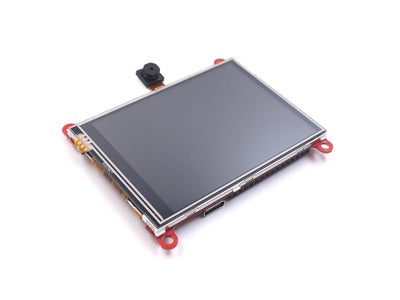

The idea is quite simple, using a cheap development board that includes a camera, ESP32-Cam connected to 3.5" TFT touchscreen. I also use built in sd-card slot on ESP32-Cam for external memory, so we can store the images on it. All parts need to be combined all together in a single PCB. Thankfully someone has created open-source project that meet with my requirements.
Thank to Makerfabs (ESP32 Touch Camera)
Based-on ESP32 Touch Screen designed by Makerfabs, I made several modifications :
  • Using CH340 rather than CP2104, because it cheaper and easy to hand-soldering
  • Changes the camera position, I don't use it for selfie cam
  • Changes the SD card slot and USB port posistion in the same side. It will helps when we insert the board to the enclosure

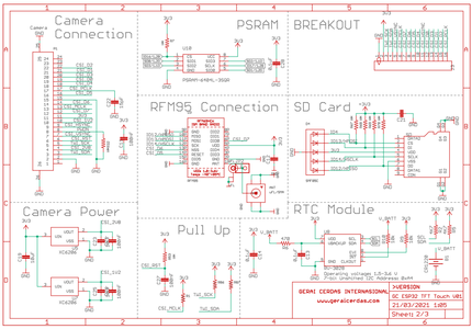

  • Add PSRAM if ESP32-S is in use
  • Add LoRa module if Camera is not in use (untested)
  • Add very accurate Real Time Clock and cell coin battery backup (untested)

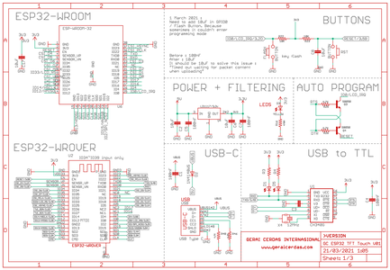

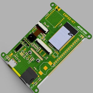

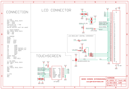

Step 2: Designing Schematic and Board Layout
The schematic and board layout are designed in Autodesk Eagle. To generate 3D model of this PCB design, simply click "Fusion 360" in board layout and create a new design. In Fusion 360 I import the components that hasn't a 3D model.
If you need a 3D model of this PCB, you can download it at my grabcad account : https://grabcad.com/library/esp32-xt-esp32-with-3-5-tft-lcd-and-camera-ov2640-1
Step 3: PCB Assembly
I sent gerber file to PCB manufacturer. After the PCB and all components are arrives, it's time to assembly all parts by hand-soldering. Actually I already bought an ESP32-Cam and 3.5" TFT display module, so it just need to desoldering all components in this two modules, and then placed in a new PCB. The rest is adding usb serial converter so it able to upload the firmware without external programmer.
Here is the link if you want to make this PCB : https://github.com/geraicerdas/esp32-xt

Pin definitions
//------ ESP32-XT pin definition --------
#define SPI_MOSI 13
#define SPI_MISO 12
#define SPI_SCK 14
#define LCD_MOSI    SPI_MOSI
#define LCD_MISO    SPI_MISO
#define LCD_SCK     SPI_SCK
#define LCD_CS      15
#define LCD_RST     26
#define LCD_DC      33
#define LCD_BL      -1
#define LCD_WIDTH   320
#define LCD_HEIGHT  480
#define LCD_SPI_HOST HSPI_HOST
