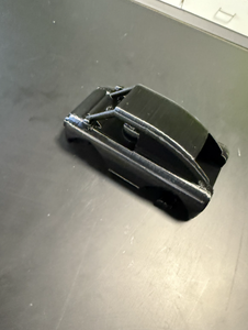

Now that the servo motor is mounted and connected to the Circuit Playground Express (CPX), it’s time to complete the build and test the car. The goal of this final stage is to secure all components, upload your code, and make sure everything functions smoothly when powered.
Start by firmly attaching the CPX to the chassis using Velcro, double-sided tape, or zip ties. Make sure it’s secure but accessible, especially the USB port, in case you need to make adjustments to your code later. Check that your servo wires are neat and not hanging loose where they could interfere with the wheels or ground.
Next, connect the front axle, wheels, or any other moving parts that interact with the servo. Double-check the alignment to ensure the car will move smoothly. The servo horn should be attached in a position that gives it full range of motion without over-rotating or getting stuck.
With the hardware in place, plug your CPX into your computer and upload your MakeCode program. It’s a good idea to test a simple version of your code first to make sure the servo is responding correctly. If it doesn’t move the way you expect, try adjusting the rotation angles or pauses between commands.
Once the code is working, plug in your portable battery or other power source. If everything is wired correctly, the CPX should light up and run your program. Place the car on a flat surface and observe how it moves. If it turns too sharply or doesn’t stay straight, tweak the servo angles or reposition the horn.
If needed, experiment with different timing in the code to fine-tune how the car moves. Adding friction to the wheels, adjusting the balance of the chassis, and keeping the wires tidy can all make a noticeable difference in performance. Once it’s running consistently, you’re done—your toy car is ready to drive!

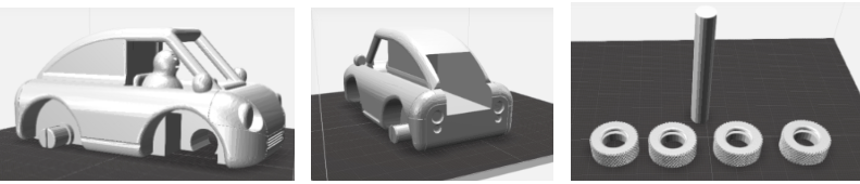

Step 2: Printing Example
  1. Download and print the following STL files using a 3D printer. Use a raft and supports.
  2. These files were designed using TinkerCAD and
  3. Mount remixed from Adafruit’s Snap-fit Mount
Car:
https://www.tinkercad.com/things/cQewQv7MkkP-fabulous-waasa-gaaris?sharecode=rO93i3UCoz1eH-_KD66ip5Ptdy0Uf_-UhbCihgTcHgI
Wheels and Rod: https://www.tinkercad.com/things/lIKVlscdAAl-spectacular-jaban?sharecode=uOAImMB7Q6ergd-J9_GlXFvjagYFXy-yAnGl_VzKAo4
Use these links and download them as STL documents. After downloading open Maker Bot. Then import the car document and make sure the printer type is set to sketch. When ready to print, export the document so it is able to convert to a makerbot document. Then do the same with the wheel and rod document to convert it into a makerbot document.
