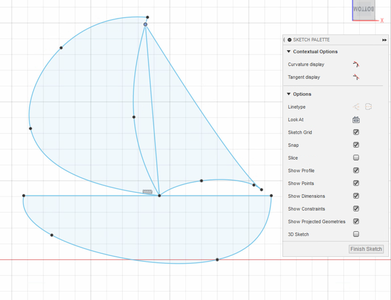

Step 5: Add Your Carousel Pieces!
Finally I sketched my sailboat and extruded it to create a body. I was then able to line it up with one of my poles and duplicate it in a circular pattern around my center axis, which lined up perfectly with my remaining poles.
