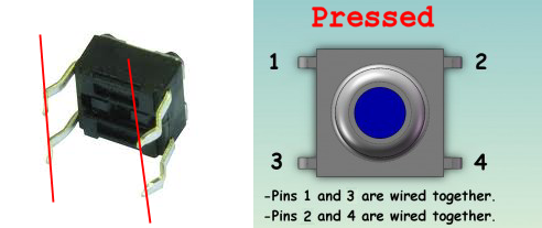

- 6 x (or more) momentary tactile push buttons (any kind is fine, but I'm using a four pin button like this)

Now, you'll need to set up the pushbuttons. Be careful to place the buttons such that the pair of pins that are interconnected close the circuit when the button is pressed. For more info on this, check out this article: The Four-Pin Switch: Hooking it up.
Then either the left most or right most pin of the pushbutton to the 10kΩ resistor, and the other pin to pin 6 of the 555 timer. Place the next button, and connect the pin of the first button which is connected to the resistor such that they are in series, and connect the other pin in the same way. Then follow this procedure for each of the subsequent buttons that you add. The image below illustrates this.
