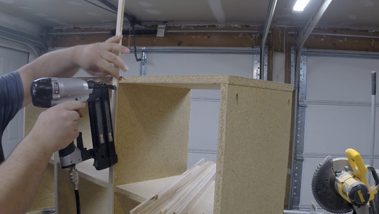

I thought for a while about how I would join all of the shelves together. Originally I considered cutting rabbets or dados, but this proved to be fairly complicated, especially with the limited tools that I have. In the end I decided that the best route would be to use pocket hole joinery.
I used a Kreg Pocket hole jig to drill all the holes and then screw all of the cabinet pieces together. In addition to the pocket hole screws, I also used wood glue on each side.
Once it is all put together, I added some thin strips of wood to the front of the cabinet. That is necessary because the ends of particle board is very porous and without the strips of wood, the edges of the cabinet would look unfinished. This is one of the drawbacks in using particle board as this is not something that I would have to do with real wood.
I also added some 2 inch wood strips in a shaker style on the sides. This hides some of the pocket holes and gives it a more decorative feel.
