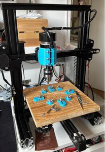

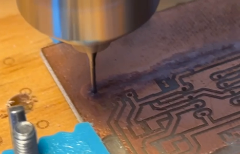

Machine Setup Overview
- Base Machine: Standard FDM 3D printer (e.g., Ender 3) modified with:
- A spindle motor or mini drill mounted in place of the extruder.
- Reinforced Z-axis for vertical stability.
- GRBL-compatible controller for CNC operation.
- Toolpath Depths:
- Trace Isolation (Z): −0.06 to −0.08 mm
- Drilling (Z): −2.5 mm (or board thickness)
- Cutout (Z): −1.6 to −2.0 mm (with tabs)

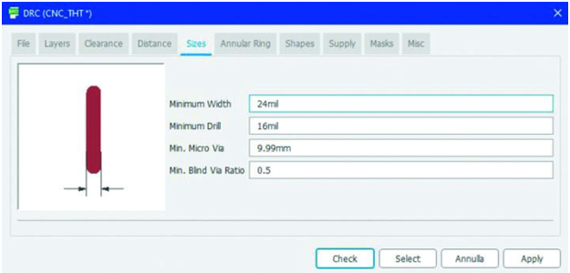

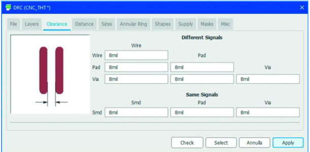

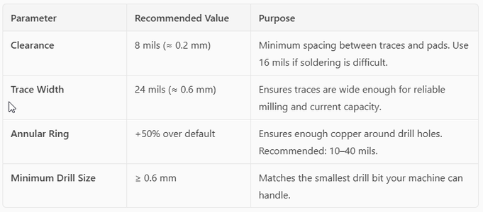

1.1 Design Rule Configuration (DRC)
Before generating Gerber files, it’s essential to configure the Design Rules (DRU) to match the mechanical capabilities of your adapted 3D printer.
ParameterRecommended ValuePurpose
Clearance
8 mils (≈ 0.2 mm)
Minimum spacing between traces and pads. Use 16 mils if soldering is difficult.
Trace Width
24 mils (≈ 0.6 mm)
Ensures traces are wide enough for reliable milling and current capacity.
Annular Ring
+50% over default
Ensures enough copper around drill holes. Recommended: 10–40 mils.
Minimum Drill Size
≥ 0.6 mm
Matches the smallest drill bit your machine can handle.
💡 Tip: Save these settings in a custom .dru file for reuse.
Step 4: Loading and Applying the DRU File in EAGLE
2.1 Load the Custom Design Rule File (DRU)
To ensure your PCB design is compatible with CNC milling and drilling, follow these steps to load the custom CNC_THT.dru file:
- Copy the CNC_THT.dru file into EAGLE’s dru directory (typically located in the EAGLE installation or user documents folder).
- Open your PCB layout in EAGLE.
- Go to Tools > DRC... (Design Rule Check).
- In the DRC window, click Load, then select the CNC_THT.dru file.
- Click Apply to activate the rules.
- Click Check to run a design rule verification.

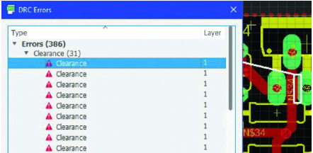

2.2 Fixing DRC Errors
After running the DRC check, EAGLE will highlight any violations. Common issues include trace clearance and pad spacing.
🔧 How to Fix Clearance Errors:
- Click on each error in the DRC report.
- Manually adjust the trace width, spacing, or pad position using the Move or Ripup tools.
- Re-run the DRC check until all critical errors are resolved.

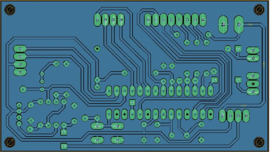

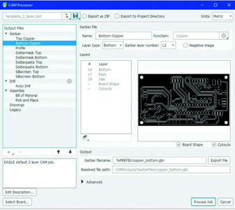

Step 5: Generating Gerber and Drill Files
Once your design passes the DRC check, you can generate the manufacturing files:

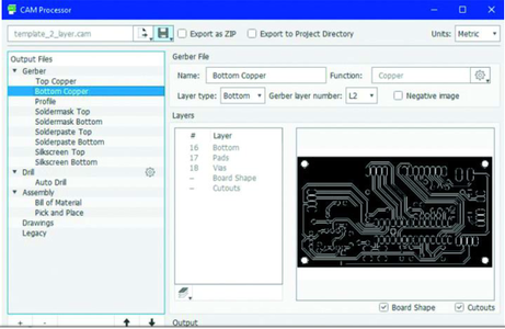

3.1 Export Gerber Files
- Open the CAM Processor from the top toolbar.
- In the CAM job:
- Select Top Copper and Bottom Copper layers.
- Enable Board Outline and Cutouts if needed.
- Click Process Job.
- EAGLE will generate a folder named CAMOutputs containing:
- Gerber files for copper layers.
- Excellon drill files.
- Board outline files (if configured).

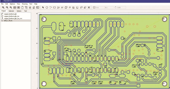

Step 6: CAM File Generation in FlatCAM
FlatCAM is used to convert Gerber and Excellon files into G-code for CNC milling and drilling. This step is crucial for preparing your PCB design for physical fabrication.

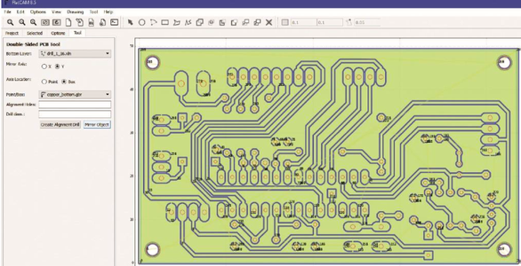

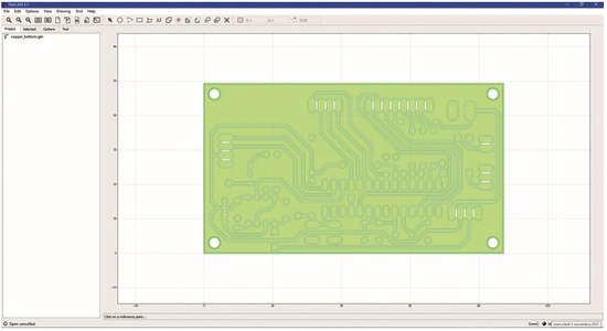

6.2 Generating Toolpaths for Copper Traces
1. Import the Bottom Copper Layer
- Go to File > Open Gerber… and select copper_bottom.gbr.
2. Configure Units and Mirror the Layer
- Navigate to Tool > Double-Sided PCB Tool:
- Bottom Layer: copper_bottom.gbr
- Mirror Axis: Y
- Axis Location: Box
- Reference Object: copper_bottom.gbr

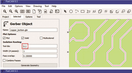

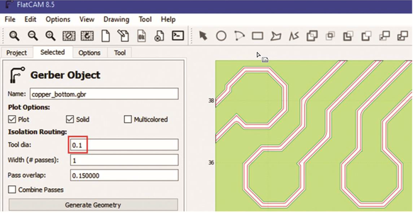

3. Generate Isolation Geometry
- In the Plot Options, enable:
- ✅ Plot
- ✅ Solid
- Under Isolation Routing:
- Tool Diameter: 0.2 mm (adjust based on your bit)
- Width: 1 (number of passes)
- Pass Overlap: 0.5 (only if Width > 1)
- Click Generate Geometry to create the isolation path.

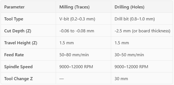

4. Create CNC Job for Traces
- Set the following parameters:
- Cut Z: -0.06 to -0.08 mm (depth of cut into copper)
- Travel Z: 1.5 mm (safe height for travel moves)
- Feed Rate: 50–80 mm/min (adjust based on material and bit)
- Spindle Speed: 9000 RPM (or your spindle’s optimal speed)
- Click Generate to create the G-code.
6.3 Generating Toolpaths for Drilling Holes
1. Import the Drill File
- Go to File > Open Excellon… and select drill_1_16.xln.
2. Mirror the Drill Layer
- Again, use Tool > Double-Sided PCB Tool:
- Bottom Layer: drill_1_16.xln
- Mirror Axis: Y
3. Configure Drill Tool Parameters
- In the Tools Table, ensure:
- Drill diameters are sorted in ascending order.
- Each tool is correctly assigned to its hole size.
4. Create CNC Job for Drilling
- Cut Z: -2.5 mm (adjust based on PCB thickness)
- Travel Z: 1.5 mm
- Feed Rate: 30–50 mm/min
- Tool Change Z: 30 mm (safe height for manual tool changes)
- Click Generate to produce the drill G-code.

Step 7: CNC Milling and Drilling
This step involves executing the G-code files generated in FlatCAM to physically mill the copper traces and drill the component holes on your PCB using a CNC machine or modified 3D printer.
🧰 7.1 Preparing for CNC Operation
Before starting, ensure the following:
- Your machine is mechanically calibrated (X/Y/Z steps/mm, backlash compensation).
- The bed is leveled and the PCB is securely fixed using clamps or double-sided tape.
- The spindle or drill motor is properly mounted and aligned.

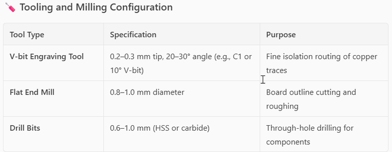

- You have the correct drill bits and engraving tools (e.g., 0.2 mm V-bit for traces, 0.8–1.0 mm for holes).

See. Recommended CNC Parameters picture.

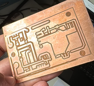

- After milling and drilling, inspect the board under magnification for:
- Burrs or copper bridges.
- Misaligned holes.
- Incomplete traces.
