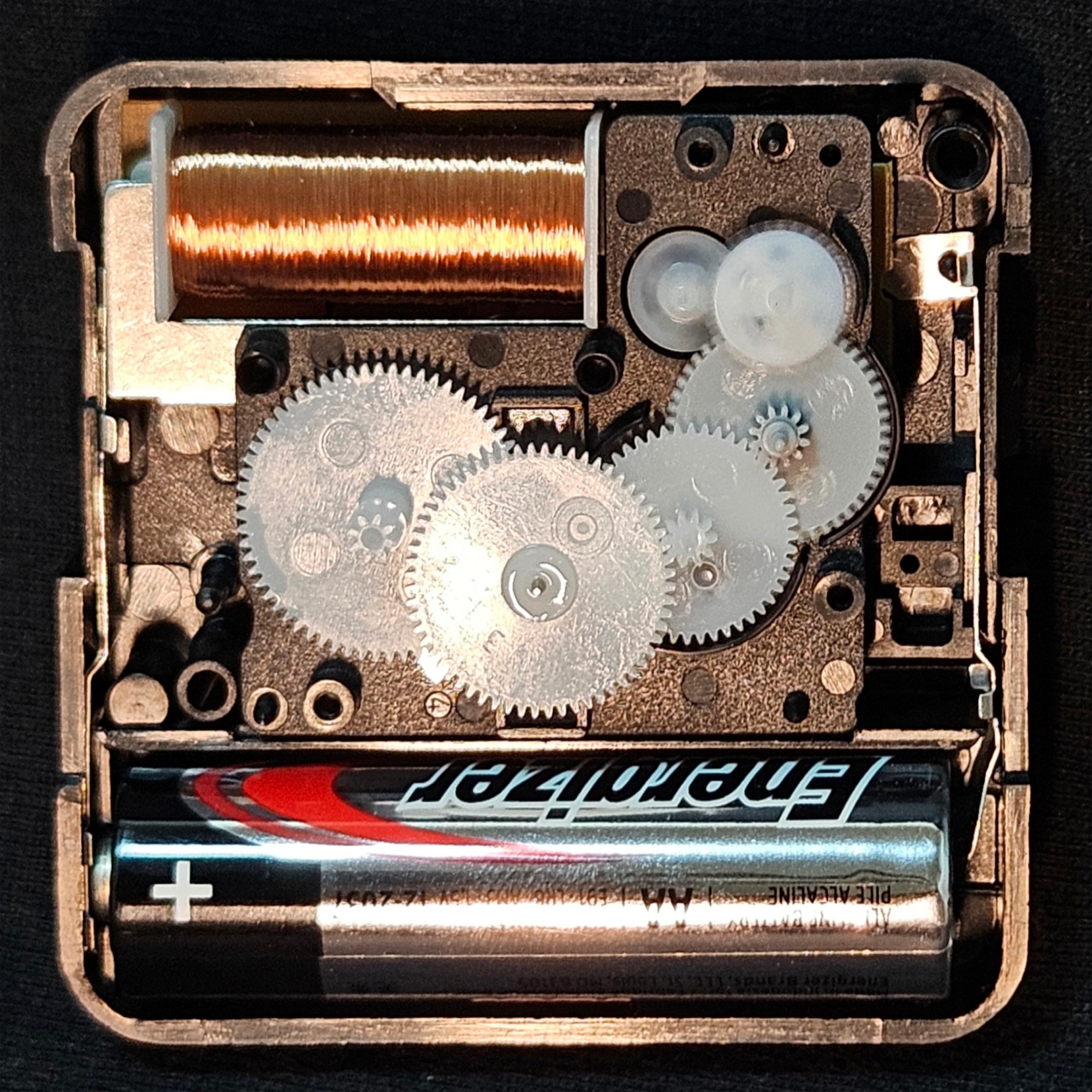

Install the movement onto ①. You must loosen and tighten the movement's nut.
