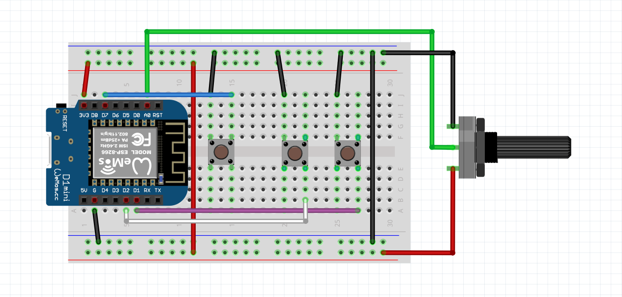

Step 1: The Controller Board Circuit
The first step should be building the controller board and verifying that all is working.
For very basic testing, you can just upload the code to a "raw" ESP8266 board.
The Circuit above is Tracey in its simplest configuration.
Note: The 5V screw terminal is if you decide to power the board from an external supply, if you decide to power the board through a USB power bank, the screw terminal can be left out - more about this later.
Step 2: Breadboard Circuit
The Breadboard circuit with servos, the power connector is optional.
An important note on powering Tracey, is that with the servos connected it is possible to power the device with a USB power bank, as they can usually supply about 1 Amp at around 5V.
Trying to power Tracey from a USB 1.0 or USB 2.0 port will not work reliably or not at all and could even cause damage to the USB port -although most ports have over current protection.
Powering from a dedicated USB hub that can supply 1 Amp per port should work OK.
Powering from a USB 3.0 port seems to work OK.
