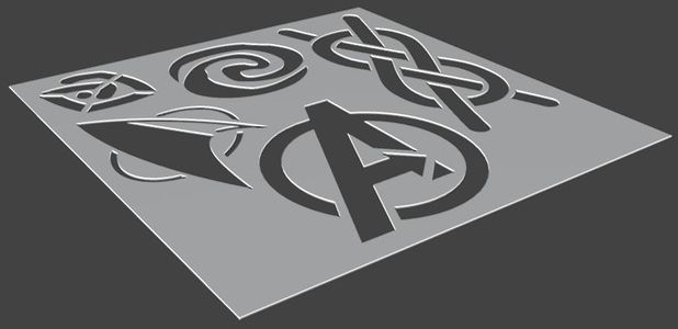

Step 2: Model Stencils
Once you have the design you like, export the image as an SVG. Import the SVG into Blender. Convert the shape from a curves object to a mesh object. Enter edit mode and select all the faces. Extrude the faces by some amount greater than you intend for the stencil to end up.
Enter object mode and create a cube. Give it the dimensions you want for your stencil sheet. The stencil sheets above for example are 100mm by 100mm by .4mm or .6mm (.4 will mean 2 printed layers, .6 will mean 3 printed layers.) The thicker the print is, the stronger it'll be. But the thinner the print is, the more flexible it'll be and the easier it'll be to trace on your skin.
Add a Boolean modifier to your stencil sheet cube. If you added all of your shapes to a collection, choose collection instead of object, and identify the collection to subtract.
Step 3: Print Stencils
Export your sheet from Blender as an STL. Choose "Selection only" and "Apply Modifiers."
Import your STL into your slicer. Make sure that it's the size you expect.
Slice the stencil sheet and then print on your printer. When it's finished: very carefully peel it from the print bed. Test out your favorite shape.
