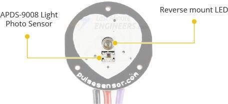

At the forefront of the sensor is the area designated for placing your finger, marked with a heart logo. Adjacent to it is a minuscule circular aperture from which the Kingbright’s reverse mounted green LED emits light.
Just below the circular aperture resides a small ambient light photo sensor – the APDS-9008 from Avago. This sensor functions similarly to those found in cell phones, tablets, and laptops, adjusting screen brightness according to ambient lighting conditions.

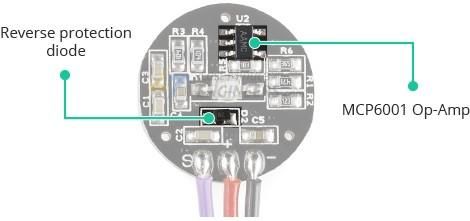

Situated on the reverse side of the module are components including the MCP6001 Op-Amp from Microchip, along with a selection of resistors and capacitors constituting the R/C filter network. Additionally, a reverse protection diode is incorporated to prevent potential damage in case of accidental reversal of power leads.
The module operates within a DC power supply range of 3.3 to 5V and consumes less than 4mA of current.

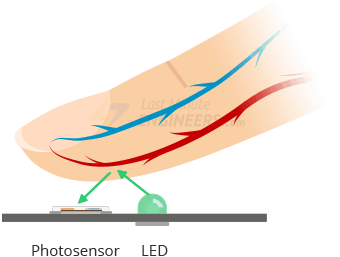

The principle behind optical heart-rate sensors is quite straightforward. If you’ve ever shone a flashlight through your fingers and observed the pulsation of your heartbeat, you can easily grasp the concept of optical heart-rate pulse sensors.
A pulse sensor, like any other optical heart-rate sensor, operates by emitting a green light (~550nm) onto the finger and gauging the quantity of reflected light with a photosensor.
This method of optical pulse detection is termed a Photoplethysmogram.

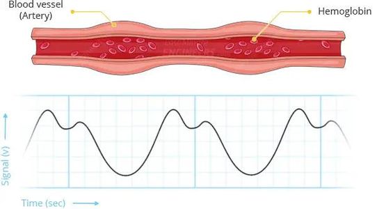

Oxygenated hemoglobin in arterial blood has the property of absorbing green light. The more red the blood (indicating higher hemoglobin levels), the greater the absorption of green light. With each heartbeat, blood flows through the finger, inducing a change in reflected light, thereby generating a waveform at the output of the photosensor.
Continuously illuminating the finger and capturing photosensor readings allows for swift acquisition of a heartbeat pulse reading.
The output signal from the photosensor is typically small and prone to noise; thus, it undergoes filtration via an R/C filter network and subsequent amplification with an Op-Amp, resulting in a significantly larger, cleaner, and more detectable signal.

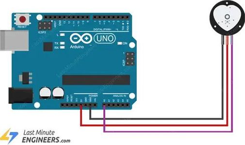

Linking the Pulse Sensor to an Arduino is a straightforward task. You’ll only need to connect three wires: two for power and one for reading the sensor value.
The module can be powered with either 3.3V or 5V. Positive voltage is attached to ‘+,’ while ground connects to ‘-.’ The third wire marked ‘S’ is the analog signal output from the sensor, which will be linked to the Arduino’s A0 analog input.
Below is the wiring diagram for Pulse Sensor experiments:
