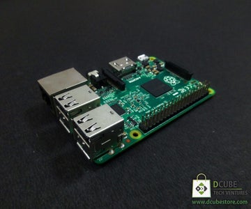

1. Raspberry Pi
The initial step was getting a Raspberry Pi board. The Raspberry Pi is a solitary board Linux based PC. This little PC packs a punch in registering power, used as a piece of electronics exercises, and PC operations like spreadsheets, word processing, web surfing and email, and games. You can buy one at any electronics or hobbyist store.

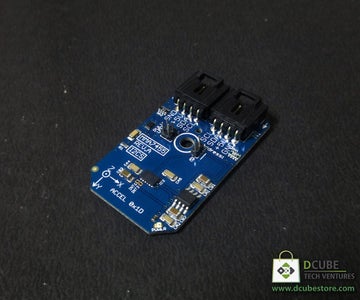

3. 3-Axis accelerometer, MMA7455
Produced by Freescale Semiconductor, Inc., the MMA7455 3-Axis Digital Accelerometer is a low power, a smaller scale machined sensor fit for measuring acceleration up along its X, Y, and Z-axis. We obtained this sensor from DCUBE Store

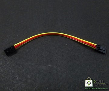

4. Connecting Cable
We acquired the I2C Connecting cable fromDCUBE Store

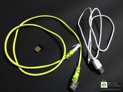

5. Micro USB cable
The slightest entangled, however, most stringent regarding power necessity is the Raspberry Pi! The most prescribed and least demanding approach to managing the strategy is by the utilization of the Micro USB cable. A more advanced and specialized path is to give power specifically by means of GPIO or USB ports.
6. Networking Support
Get your Raspberry Pi associated with an Ethernet (LAN) cable and interface it to your home network. On the other hand, scan for a WiFi connector and utilize one of the USB ports to get to the remote network. It's a sharp decision, fundamental, little and simple!

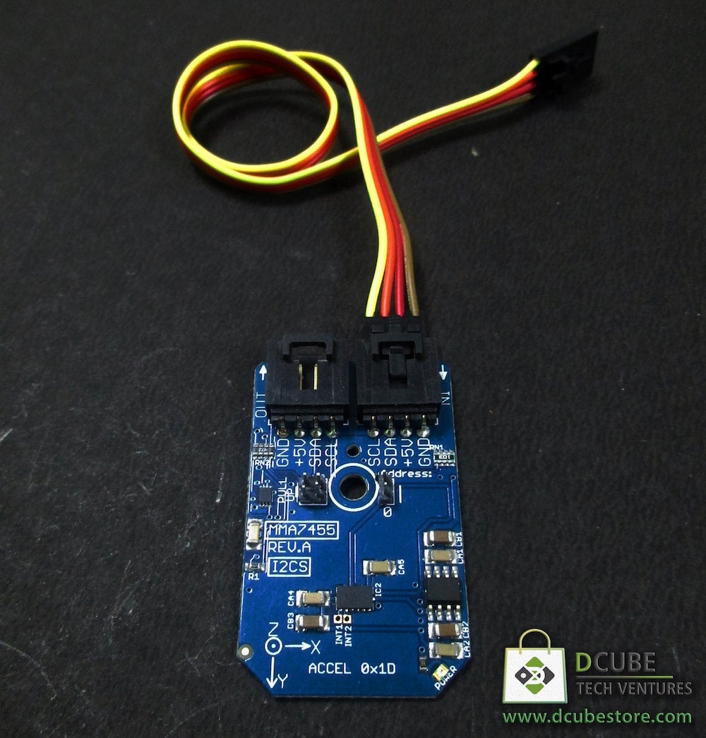

Make the circuit as indicated by the schematic showed up. In the schematic, you will see the connections of various electronics components, connecting wires, power cables, and I2C sensor.
Raspberry Pi and I2C Shield Connection
As a matter of first importance take the Raspberry Pi and spot the I2C Shield on it. Press the Shield nicely over the GPIO pins of Pi and we are finished with this progression as easy as pie (see the snap).
Raspberry Pi and Sensor Connection
Take the sensor and Interface the I2C cable with it. For the suitable operation of this cable, please review I2C Output ALWAYS takes up with the I2C Input. The same must be taken after for the Raspberry Pi with the I2C shield mounted over the GPIO pins.
We recommend the use of the I2C cable as it negates the requirement for dissecting pinouts, securing, and bother accomplished by even the humblest mess up. With this significant association and play cable, you can present, swap out contraptions, or add more gadgets to an application suitable. This supports the work weight up to an immense level.
Note : The brown wire should reliably take after the Ground (GND) connection between the output of one device and the input of another device.

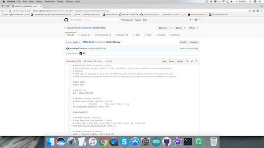

You can see the Python Code for the Raspberry Pi and MMA7455 Sensor in our GithubRepository.
Before continuing to the code, guarantee you read the standards given in the Readme chronicle and Set up your Raspberry Pi as indicated by it. It will simply relief for a minute to do in light of current circumstances.

The going with is the python code and you can clone and change the code in any way you incline toward.
<p># Distributed with a free-will license.<br># Use it any way you want, profit or free, provided it fits in the licenses of its associated works.
# MMA7455L
# This code is designed to work with the MMA7455L_I2CS I2C Mini Module available from dcubestore.com
# http://dcubestore.com/product/mma7455l-3-axis-low-g-digital-output-accelerometer-i%C2%B2c-mini-module/</p><p>import smbus
import time</p><p># Get I2C bus
bus = smbus.SMBus(1)</p><p># MMA7455L address, 0x1D(16)
# Select mode control register, 0x16(22)
#		0x01(01)	Measurement Mode, +/- 8g
bus.write_byte_data(0x1D, 0x16, 0x01)</p><p>time.sleep(0.5)</p><p># MMA7455L address, 0x1D(16)
# Read data back from 0x00(00), 6 bytes
# X-Axis LSB, X-Axis MSB, Y-Axis LSB, Y-Axis MSB, Z-Axis LSB, Z-Axis MSB
data=bus.read_i2c_block_data(0x1D, 0x00, 6)</p><p># Convert the data to 10-bits
xAccl = (data[1] & 0x03) * 256 + data [0]
if xAccl > 511 :
	xAccl -= 1024
yAccl = (data[3] & 0x03) * 256 + data [2]
if yAccl > 511 :
	yAccl -= 1024
zAccl = (data[5] & 0x03) * 256 + data [4]
if zAccl > 511 :
	zAccl -= 1024</p><p># Output data to screen
print "Acceleration in X-Axis : %d" %xAccl
print "Acceleration in Y-Axis : %d" %yAccl
print "Acceleration in Z-Axis : %d" %zAccl</p>

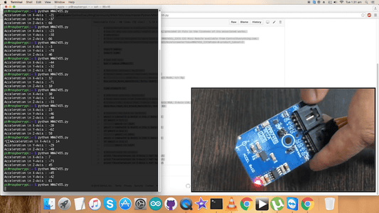

Step 4: The Practicality of the Code
Download (or git pull) the code from Github and open it in the Raspberry Pi.
Run the commands to Compile and Upload the code in the terminal and see the yield on Screen. Taking after a few minutes, it will display each one of the parameters. In the wake of ensuring that everything works easily, you can utilize this wander each day or make this wander a little part of a much more prominent task. Whatever your needs you now have one more contraption in your gathering.

The MMA7455, manufactured by Freescale Semiconductor, a low-power high-performance 3-axis digital accelerometer can be used for Sensor Data Changes, Product Orientation, and Gesture Detection. It's perfect for applications such as Mobile Phone/ PMP/PDA: Orientation Detection (Portrait/Landscape), Image Stability, Text Scroll, Motion Dialing, Tap to Mute, Laptop PC: Anti-Theft, Gaming: Motion Detection, Auto-Wake/Sleep For Low Power Consumption and Digital Still Camera: Image Stability.
