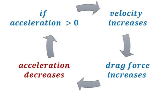

  • At the very first moment, its velocity is zero, therefor the drag is zero too, and the acceleration is g (free fall acceleration).
  • Immediately afterwards, the velocity is already larger than zero and the drag increases with it.
  • The acceleration is therefore now smaller than g, but the velocity continues to increase, and with it the drag, and acceleration continues to decrease.
So, like in a negative feedback loop, the velocity increases while the acceleration decreases. The process will end when the drag will be equal to the weight, and the acceleration will be zero. From this moment the parachutes keeps moving at a constant "terminal velocity".

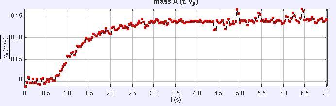

The velocity of the seed grew as expected from the explanation in step1- velocity increases while acceleration decreases, till it reaches a constant speed.

And the result, in the attached graphs: same functional behavior, but with higher terminal velocity.
For the "full pappus" case, I measured terminal velocity of about 0.13-0.14m/sec.
For the "half pappus" case, I measured terminal velocity of about 0.23 m/sec.
