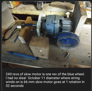

For the timing device, a slow syndronous motor, 1 rpm or slower, an old oscillating fan, (to gear down the rotation from the slow motor), a programable timer (to start and stop the slow motor power at the right times of the day, and to (throughout the day) turn on and off the slow motor again and again so that the gearing down is exactly right to move the reflector at 15 degrees per hour. Some fishing line. A small aquarium bubble pump. This provides air to give you the gradually increasing air pressure that you need to control the speed of rotation of the reflector and air to run the airlift pump that lifts water to turn the waterwheel that powers the winch that turns the reflector. Tubes and garden hose to bring the air to the solar cooker and to make the airlift pump. A one ft square piece of 3/4 inch plywood to make the waterwheel, an old oscillating fan to use as the axle for the waterwheel and the winch. 18 plastic cups to make buckets for the waterwheel and 18 short wood screws to hold the buckets in place. For the water pressure controllers about 18 inches of light rubber tubing , and one length (10 ft of 4inch white pvc drainage pipe. I cut up old ties for concrete forms to make the little levers that clamped the rubber tubing that controlled how fast the air went to the airlift pump.

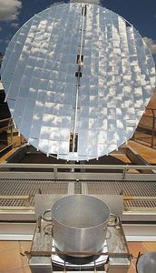

Step 1: Scheffler Solar Kitchen, Why It Is Great and Its Weak Points.
Wolfgang Scheffler is an Austrian Physicist who trained in Germany. He could probably got any job he wanted but instead he wanted to build a tracking solar cooker that he had come up with. It required some fairly complex welding, etc. and he couldn't get it done cheaply enough in Germany. So he went volunteering in Kenya, and using cheap local labor, he was able to get the thing made to his specifications. He built the solar kitchen that he wanted to build. It wasn't perfect of course so he worked to fix its teething problems for about a year. People in India were interested, so he went there and build more and bigger Solar kitchens. This was a success too. Scheffler solar kitchens have a big mirror that is well balanced and that uses a clockwork to make it rotate at 15 degrees per hour, and maintain the sunlight on one spot all day, and every day. this is usually a hole in a wall where the light heats up the underneath of a cooking surface. This saves the cook from being blinded by the light, or getting heat stroke from the hot sun beating down on his or her head or back. It is great! So what is the problem? Scheffler's solar kitchen has a big reflector that rotate slowly, and every few days it must be adjusted to maintain its focus on the heat window into the kitchen. Other tracking solar cookers are more like big guns on gun turrets, they have to raise and lower to the right angle and turn at each adjustment. Minimum 2 motors and usually a solar tracker to to point at the sun. Scheffler's is way simpler to use. One motor, one speed all day. But the suns path is a little higher or a little lower in the sky every day, so after a few days, you have to readjust the elevation. Every time you redirect it, it automatically changes the angles of each of the individual small mirrors that make up the Scheffler reflector. All 200 of them in the case of the photo! The lens shape itself is adjustable! Even though the change is automatic, and it is done this way to maintain the balance of the device, the cost of Scheffler devices is much greater due to this feature. I have seen university studies of Scheffler solar kitchens from the USA. It can take an entire semester to make one! An ideal tracking solar cooker should be possible to make in your shop in part of a day and whether you make it or buy it, almost every other reflector in the world are fixed focus. So really the task is to make a rigid reflector work a bit like a Scheffler system. One rigid reflector to replace 200 on a deformable metal grid.

I sometimes had a lull in work over the summer, and would try to arrange my thoughts in a coherent way. And perhaps I even got close to a working solution but I never actually cooked things with those attempts. The part that I never came close to figuring was an accurate timing mechanism. Good clocks were made about 200 years ago, by the British Navy but I couldn't come close to making a decent timing mechanism. I tried to adapt various analogue clocks and timers over several years and nothing worked. I did figure out something that would work, with a little electronic timing system inside but I didn't know how to make it.
Step 4: Fall 2023 the Real Deal Timing Sorted! Not Ideal But It Works.

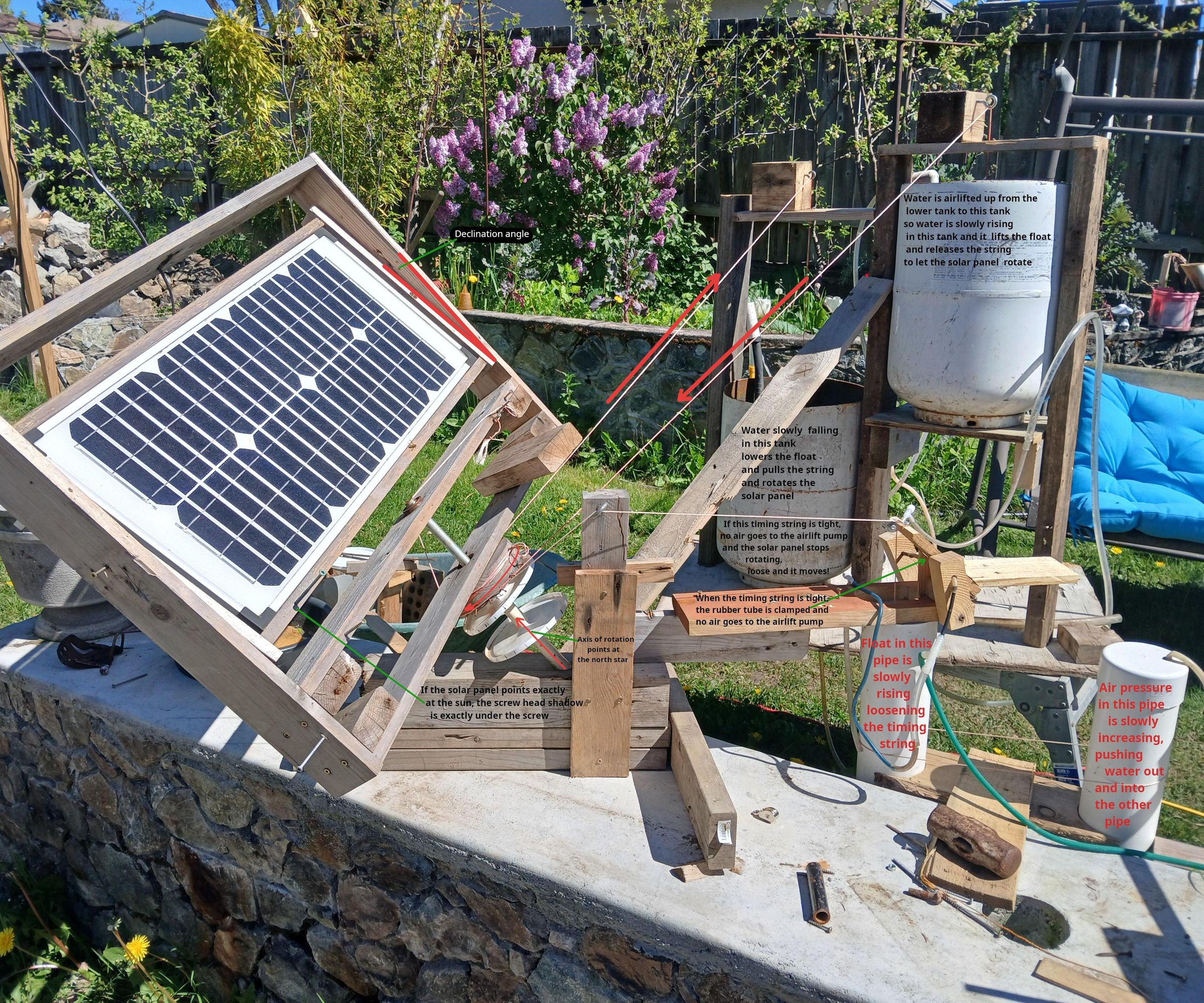

Note, this is clunky, it is not what I wanted to do but it works. I had the spare time in 2023 and decided to make a clunky workaround for the timing problem. I couldn't make a little electronic device to time the rotating of my reflector and I had spent years trying. I just don't know how. BUT! I had continuous low pressure air (roughly 3 ft of water pressure) for my pond aeration and for mini airlift pumps in the greenhouse so I made a system that would let that air from the air pump into another pipe. This was very clunky! When you buy a synchronous motor it must be either CW (clockwise) or CCW, (counterclockwise) the first one I bought was CCW/CW which means it can rotate either way every time it gets switched on! (Which is useless!) I bought a cheap synchronous motor that turned at about 1 rpm (much too fast for timing) and I had it attached on an old oscillating fan where the fan blades should be, it turned the fan shaft which geared everything down to turn the oscillating part, to which I attached a wheel and I attached fishing line to the wheel, the fishing line lifted a float that controlled the air pressure in the system. The air pressure was the same everywhere in that little closed system and gradually increasing. So whatever I produced in the shed could be replicated anywhere in the system. (I only did 2 equatorial mounts, but they both replicated what my timer at a distance did.) The gearing isn't perfectly synchronized to turn the reflector at 15% per hour, in my case, it was turning it almost twice as fast as needed. You would have to be a great engineer to calculate and cut gears to get it exactly right. And that is why I have a programmable timer, I have it turn on for a minute or two, then off for a minute or 2 and do it continuously. I only needed it to work for about 10 hours per day, so I had it turn on to do that cycling about 8.30 and then off again at about 6.30 pm. And then I would just unwind the fishing line a few turns ready to start again in the morning. This would work perfectly if my system did an exact number of turns of the blue plastic wheel in 10 hours, but it didn't do an exact number, so my reflector would have to be adjusted in the morning to point at the sun. So, I began tweeking the length that the timer ran. After a few days, I found the spot, I just left it run till something like 7.15 pm and it did an exact number of turns, and I could reset it for the morning, and it would restart automatically at the right time.
Step 5: Testing. My First Working Tracking Equatorial Mount Ran a Solar Panel
My first working equatorial mount was for a solar panel. There were 2 reasons, number 1, isolar panels don't need to be perfectly pointed at the sun, so I if things were not perfect, they were still good, and number 2. It is very easy to know where a solar panel is pointed. It often isn't so clear with a parabolic dish how accurately it is aimed. A 3rd reason is because I was asking others what material to make the reflector from. And the answers I was getting were not making sense.

Step 9: New Timing Method for Rotating the Reflector
I had a big container of water with a float in it and another closed container which I could fill air into to push water into the float container. I reasoned that this was so overbuilt and powerful that it would keep the reflector accurately pointed at the sun. It didn't because the center of gravity changed during the day, so I set it up in a different way. The air pressure in the timing part lifted a float that was attached by string to the rotating wheel of the fork mount. If it lifted it high enough an air valve (connected directly to the normal air pressure system) opened. Then air pushed into the closed barrel, forced water into the float container and lifted the float until the fork mount moved enough to close the valve. This worked great. Also at the end of the day, when the air pump stopped, pressure dropped due to a small leak in the system, and the reflector returned to its start position! It was now totally automatic!
