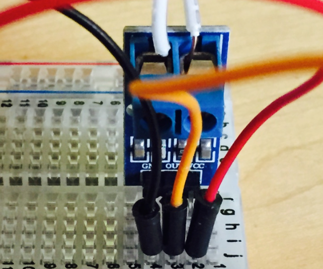

Step 3: Choose Your Light Sensor
The first picture above shows the wiring of the photocell sensor with 10K resistor to ground. The photocell is passive, meaning that it doesn't supply it's own current. It simply changes resistance such that in full light it provides no resistance and you should read 1024 off of A4. My testing in the sun with this setup showed that the photocell could maybe use some more resistance. It shot up to 1024 long before the cell was directly facing the sun, but it will work find with the limited amount of light produced by a desklamp.
The second picture above shows a solar cell connected ground-to-ground and positive to A4. Since the solar cell generates it's own current which the Arduino ADC can handle, you can plug it directly in. The one I'm showing here is a 2.2V cell. Measure the output in direct sun with a multimeter (VDC). Any cell under 5V will work here.
Use your two long pieces of wire and attach the photocell or solar cell to the end of the actuator. Be sure to insulate the leads of the photocell or the back of the solar cell. I covered the back of the solar cell with electrical tape.
