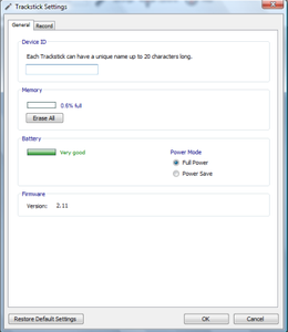

In the Tools section, Trackstick settings - This is where you setup your Trackstick. Let's focus on the General tab !
Device ID lets you configure the name of the Trackstick, up to 20 characters long.
The Memory gauge lets you know how much data is on the stick - in my experience it's more accurate than the gauge on the Trackstick Manager main screen, but I might be mistaken.
The Battery gauge does just what it is supposed to do and the two different Power mode settings on the right of the Battery gauge let you choose between Full Power and Power Save. The difference ? Full Power checks position every 5 seconds, and Power Save every 15 seconds.
The Record settings are pretty good as they are already, so I suggest you don't fiddle with them. The only thing worth changing would be the Time Zone, but even this can be achieved differently - we'll get to that part in a moment. And if you really want to change something in this second tab of the Trackstick settings, feel free to check the Help file !

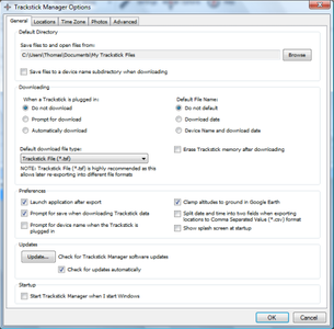

General tab
Default directory - Lets your choose where to save your files when you download data from the Trackstick. Change the path if you don't like where it points.
Downloading - This is where you tell the program what to do when it detects a Trackstick.
Preferences - Dictates the behaviour of the Trackstick Manager.
Updates - Software updates options.
Startup - Decide whether or not you want the program to start on Windows startup. Moving on !

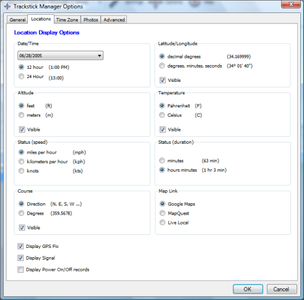

Locations
This is where you'll find a load of options to setup your Trackstick data - time, coordinates, temperature,speed...Go around and experiment, you're not going to hurt your device by changing things in this menu.

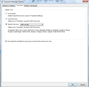

Time zone
This is where you're going to adjust your Trackstick's time data. As you can see, the first option "As recorded" lets you stick to the time when the data was recorded on the Trackstick. To give you an example, if you previously set the stick to record data according to the place where you live, traveling to another country won't adjust the time when the data was captured. On the other hand, chosing the Specific Time Zone option will allow the software to do the necessary calculation and figure out when, according to the timezone chosen in the software, the data was recorded.

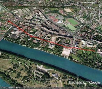

Now that we've seen the basics of how to use and setup a Trackstick, there isn't much left for me to tell you ! The files I've attached with this part of the Instructables are, respectively, the Trackstick data gathered from my taking a shortcut to work shortly after getting out of work (opens in Trackstick Manager), the same data exported into Google Earth format (opens in Google Earth), and a picture of the data as seen in Google Earth (just open it already).
Now it's your turn to go out there with your device, enjoy using it, and helps us save the world by running in the streets of a town nearby following the itinerary devised by yourself and your friends - you'll find a list of the City Labyrinths that have already been designed there. Once you're done following your labyrinth as exactly as possible with your Trackstick, go and check this Instructable by Kai, which explains in detail what to do with your Trackstick data and how to help the Multiverse make the most of it.
You'll find below one of the designs that have been suggested for the town of Paris - yes, that Paris in France - that spans on a distance of about 35 miles to be trodden on foot, car, bicycle, Segway...Whatever we can find, really. Wish us luck ! And if you want to join the quest to bring the Earth back into the Ring of Worlds, we can use all the help you have to give !
