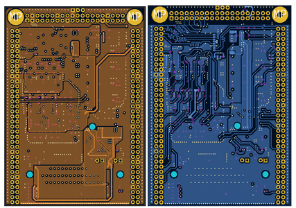

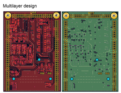

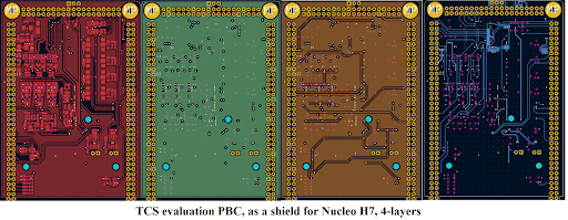

TC (Traction control) is a PCB designed and assembled by members of PUT Motorsport - a Formula Student team from Poznań University of Technology. Our goal is to create a functioning racing car in order to participate in competitions all around the world - thus our PCB’s need to be well thought of and carefully created with the highest precision and standards.
The brain of the project and main computational force of the board is an STM32H743ZIT6 MCU on Nucleo 144 Development Board. Rest of the components can be found in our github repository(https://github.com/orgs/PUT-Motorsport).

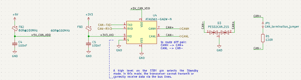

Step 4: CAN Interface
Our car uses CAN bus for device communication. TC sends different frames containing valuable data such as car state, suspension position, cooling water temperature and pressure and wheel speeds.

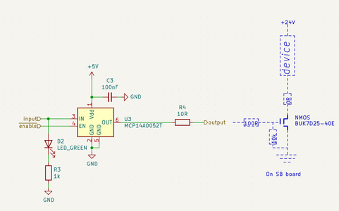

Step 5: Brake Light Control
