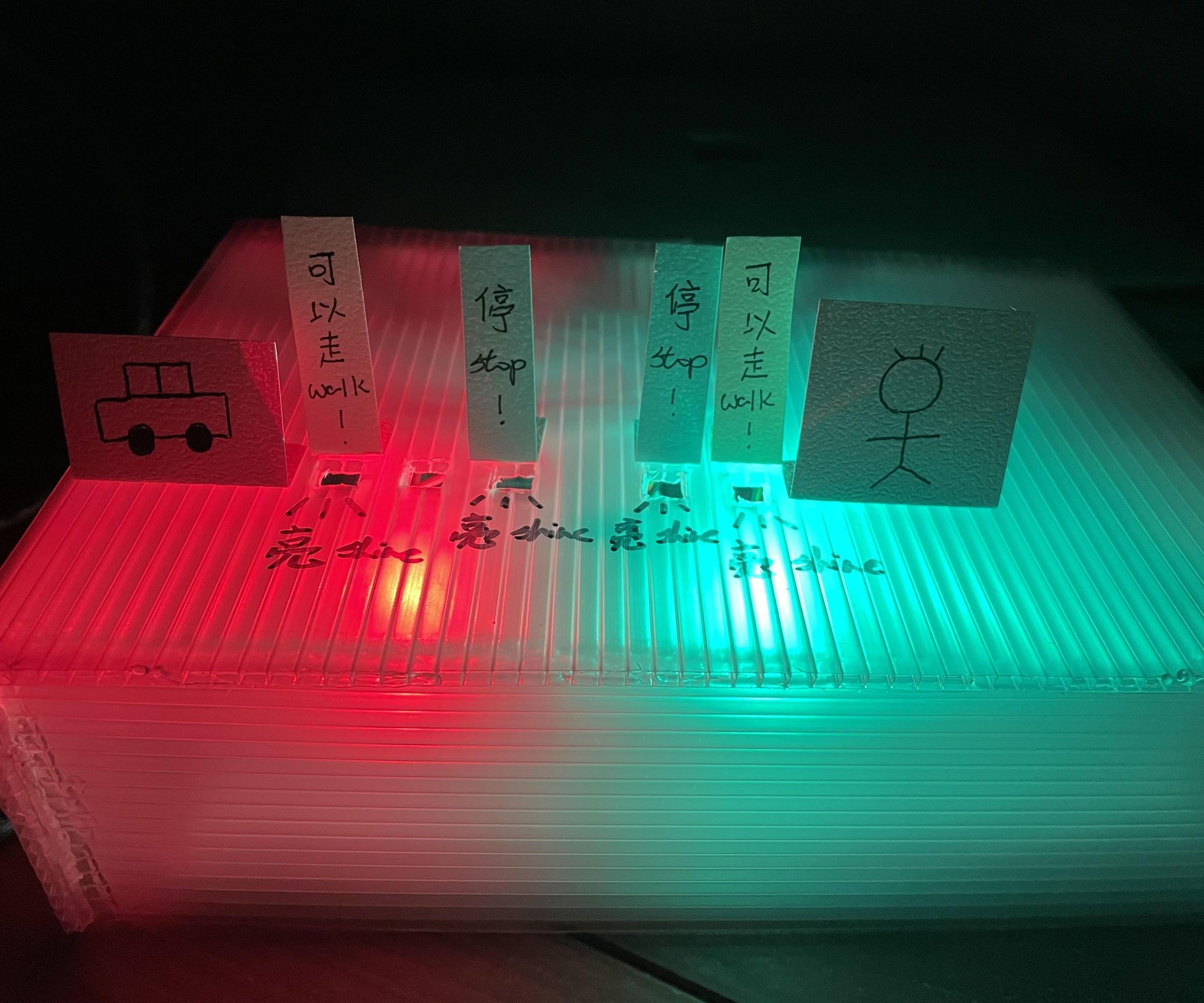

About this project:
This project is making a traffic light simulation system with an LED blinking technique. This project's main goal is to teach young children how to recognize when they can pass the street by looking at the traffic light. There are two sets of traffic lights on the breadboard, the left side is the traffic light of cars, the right side is the pedestrian traffic lights. When the light of cars turns red, the light of pedestrians will turn green. When the light of cars turns green, the light of pedestrians will turn red. Moreover, there is a yellow light on the traffic light of cars, it is for letting people know the traffic light of cars and pedestrians is turning either red or green. In addition, there are four white LED lights that simulate the countdown timer you will usually see when you are crossing the road. The four white LED lights shine at the same time as the yellow LED light. As the four LED lights blink after five times, it means that the traffic light of cars and pedestrians is turning either red or green!!!

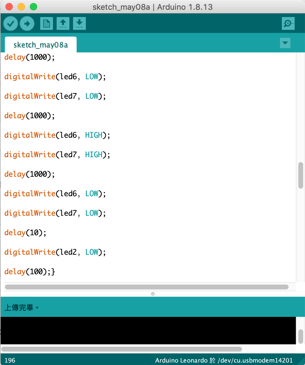

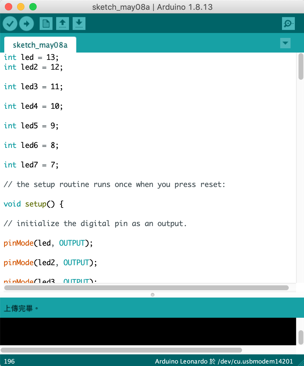

Step 2: Program the Arduino (coding)
Code Link: https://create.arduino.cc/editor/jacquelinewang911...
Paste the following code into the Arduino software and upload it to the Arduino
