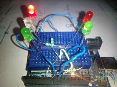

Step 1: Requirements :-
- Arduino UNO r3 or any other Arduino Board
- Breadboard/Mini Bread board
- 2 x Red Led
- 2 x Green Led
- 1 x Yellow Led
- 5 x 220ohm or 150 ohm resistors
- Male-to-Male jumper wires
- Desktop or lappy with Arduino IDE Software installed in it with some basic information about how to use it.
Step 2: Basic Information About Parts and Links to Buy -
Visit My Blog for Basic Information About Parts and links to Buy them Here
Step 3:
"Important"
- Open The Attached Circuit Image I used Red Led in Image but All leds are labled. Follow The Written Lable on the LEDs
- Assembly is very simple in this project Just Make sure that All the short legs will be connected to the ground(GND) pin of Arduino.
Step 4: Code for Arduino Board to Make Traffic Light System With Pedestrian Crossing Light:-
Download The .ino File From
Traffic Light System with Pedestrian Crossing lights
Direct Link:-Traffic Light System with Pedestrian Crossing lights.ino

Step 5: Final Result
Blog Page:-Traffic Light System with Pedestrian Crossing lights
I hope That After Reading and follow all the steps and guide you can make a Traffic Light System with Pedestrian Crossing lights without any difficulty. Thank you for reading And Keep Visiting.Follow us on We Observed's Facebook Page and if you have any confusion please use the comment section.
