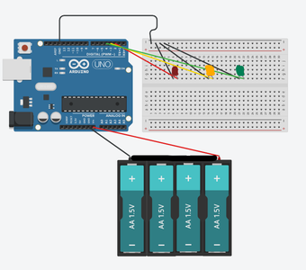

paste the breadboard on the battery pack with the included adhesive double sided tape and paste the Arduino on the side of the battery pack with some double sided tape also add a switch on the battery pack if it does not include 1 (mine does so I did not put it in the supplies)
Step 2: Give Power to Your Arduino
connect the female wire to a male to mall wire do this for positive and negative poles and then connect positive to vin and negative to any gnd
Step 3: Connect the Gnd
this is a simple but crucial step connect the gnd of the Arduino with a negative power rail
Step 4: Add All Leds
add all leds as shown it the picture then connect their gnd and their positive with pins with pins 2 - red 3- yellow 4- green if you are still confused you can check the image
Step 5: Enter Code
