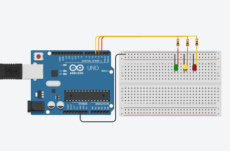

Step 1: Wiring
Let's start wiring! This step should be fairly simple, as we are just wiring up 3 LEDs with some resistors thrown in. First, you want to connect the GND pin to a negative rail on your breadboard. Next, put 3 LEDs on the breadboard do not put them stacked put them beside each other (left to right)! Now, attach 3 wires to your breadboard to their each of their pins (2, 3, 4). Now, we should have a mess. I mean we should connect resistors to the wires and then connect the wires to their respective LED, the anode of their LED. Now, it's time of coding!
Note: I'm sorry about the explanation, I put a picture for reference :)
