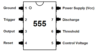

  • 2 x 555 Timer ICs

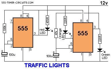

Step 1: Circuit Diagram

Step 2: Logic Break Down - Green Cycle
Immediately after we power ON this circuit, the output of the first 555 timer IC will be in ON state because the voltage at PIN-3 (Trigger Pin) is less than 1/3rd of the supply voltage. The red LED cannot turn ON yet, but the second 555 IC is powered and so the green light turns ON.
Step 3: Yellow Cycle
The capacitor of the 2nd 555 timer IC slowly charges and as soon as it charges to 2/3rd of the supply voltage (Threshold Voltage), the output of the 2nd 555 IC turns OFF and the yellow LED glows because the discharge pin is activated.
Step 4: Red Cycle
Normally the yellow LED would turn ON for the same time as the green LED. But even before the capacitor of 2nd 555 timer IC reaches 1/3rd of supply voltage, the voltage across capacitor of 1st 555 timer IC reaches 2/3rds of the supply voltage and so the output of 1st 555 IC turns OFF, resulting in yellow LED turning OFF and the red LED turns ON. The Cyle repeat with Red On.
