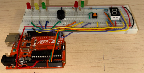

Here are some pictures to show how the wiring should look.
  1. Arduino Pins: Some analog pins like a0 - a5 are used to connect components like the 7-segment display to save space.
  2. LEDs: Each LED is connected to a resistor and a digital pin on the Arduino.
  3. Push Button: It’s wired with a pull-down resistor to detect when the button is pressed.
  4. 7-Segment Display: A common cathode/anode display is connected through resistors to protect it from too much current.
  5. Buzzer: Connected to a digital pin to provide sound signals.

This project uses 5 LEDs, a push button, a 7-segment display, and a buzzer. The code controls everything and includes these features:
Traffic Light Cycle: The car lights switch between green, yellow, and red.
Pedestrian Crossing: Pressing the button starts the pedestrian crossing.
7-Segment Display Countdown: Shows how much time is left for pedestrians to cross.
Buzzer Alerts: Makes a sound during the crossing to keep it safe.
How It Works:
  1. The traffic lights follow the usual cycle: green to yellow to red.
  2. When the pedestrian button is pressed, the car light turns red, and the pedestrian light turns green.
  3. The 7-segment display counts down (e.g., from 10 seconds).
  4. The buzzer makes a sound while pedestrians are crossing.
  5. After the countdown, everything resets to the starting state.
