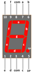

7 Segment Display:
Check out the Diagram I have given about 7 Segment Displays above. In the code below, the numbers represent the pins on the Arduino UNO. The letters represent pins on the 7 Segment Display. If you look at the 7 Segment Display, there are letters ranging from a - g. To wire this correctly, Wire one end of a Wire to the pin specified on the Arduino, and wire the other end of the wire onto the letter specified on the 7 Segment Display. For example, on the Arduino, pin 12 would connect to the top right of the 7 Segment Display. Pin 9 on the Arduino would connect to the bottom left of the 7 Segment Display. It gets easier with more practice, as I was also confused about how to wire 7 Segment Displays!!
7 Segment Display Code:
int a = 13;
int b = 12;
int c = 11;
int d = 10;
int e = 9;
int f = 7;
int g = 8;
