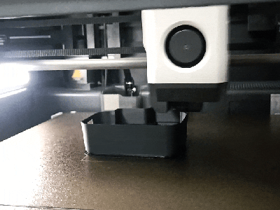

Step 2: Design
The TrailGuard was designed with functionality and wearability in mind, although it ended up being somewhat bulky. Certain components, such as the ESP32 and the GPS module, are somewhat large, so the case had to be made to fit them in, which made it bulky.
I created the whole enclosure in Fusion 360, ensuring that there is sufficient space for the perfboard, battery, buttons, and sensors. The rocker switch and the buttons were placed with easy accessibility, and the OLED screen is situated so it's easily viewed while wearing the band.
The 3D-printed enclosure holds everything together and safe, even though the band itself is somewhat chunky. I attempted to make it as small as possible, but the main concern was ensuring that everything could fit safely and work properly. Even with the size, the band is wearable and completely functional for testing and use in the field.

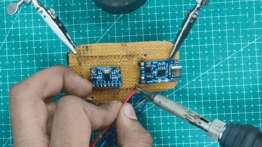

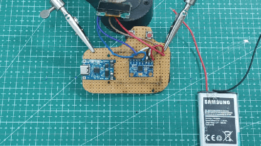

Step 3: Preparing the Perfboard
Before wiring everything, I started by tracing the outline of the 3D-printed case onto the perfboard and then cutting it to size. This ensured the board would fit neatly inside the enclosure without any unnecessary gaps.
For this design, the major components - ESP32, MPU6050 gyro, Type-C charging module, rocker switch, and the two push buttons - were directly soldered onto the perfboard. This keeps the wiring clean and sturdy, and reduces loose connections. Smaller components like the OLED and heart rate sensor can later be connected via short wires or headers.
By fixing the main modules directly onto the board, the structure became more compact and stable, making it easier to fit everything into the case and handle during testing.

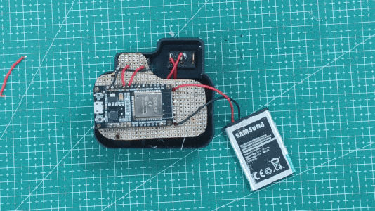

Step 4: Circuit Connections
Here’s how all the components are connected on the perfboard:
  1. ESP32 – acts as the main controller.
  2. OLED Display (SSD1306) → SDA: GPIO32, SCL: GPIO33
  3. MPU6050 Gyro + Accelerometer → SDA: GPIO32, SCL: GPIO33 (shared I²C bus)
  4. MAX30102 Heart Rate & SpO₂ Sensor → SDA: GPIO32, SCL: GPIO33 (shared I²C bus)
  5. GPS Module → TX: GPIO16, RX: GPIO17
  6. Mode Switch → GPIO25
  7. SOS Button → GPIO26
  8. Rocker Switch → inline with battery to control main power
  9. Battery + Type-C Charging Module → battery connects to ESP32 VIN & GND via charging module
Tips & Layout:
  1. I soldered the ESP32 facing downward and the push buttons flat on the board for easy access.
  2. The Type-C charging module sits on top of the board for convenient wiring and access to the charging port.
  3. The MPU6050 gyro is positioned on the bottom side to keep it stable and reduce vibrations.
  4. The OLED and MAX30102 are connected via wires, not soldered directly, and will be attached to the case with hot glue. This allows positioning on the wrist strap and keeps the display and sensor visible during use.
  5. Using this layout keeps the board compact and organized while making sure all components are accessible and functional.

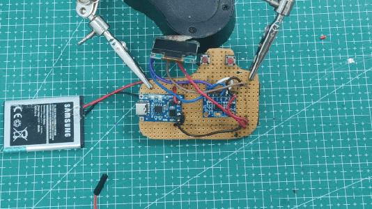

Step 5: Power Source
Since I needed a thin battery to fit inside the band, I used a small Samsung phone battery. I soldered wires directly onto its connectors and hooked it up to a Type-C charging module. From there, the charging module is connected to the ground of the ESP32 and the rocker switch, which acts as the main power control.
This setup keeps everything compact and allows the band to be recharged easily while still providing stable power to all components.

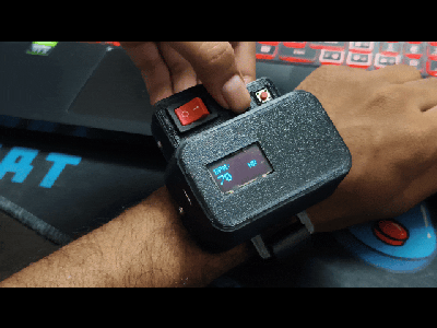

Step 6: Assembly
For the final assembly, I kept things straightforward:
  1. The OLED display was fixed on the top of the case for clear visibility.
  2. The PCB with the ESP32 and other components was placed in the middle section.
  3. The MAX30100 sensor was positioned at the bottom so it could make direct contact with the skin.
  4. Finally, the strap was attached to the sides, turning the body into a wearable band.
This arrangement kept the components organized and made the prototype easy to wear and test.

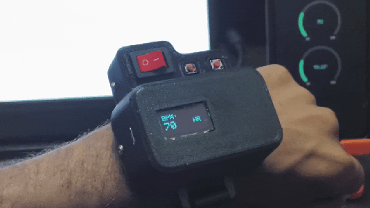

Step 9: Testing
Once the hardware was assembled and the code uploaded, I moved on to testing the TrailGuard band. The process was carried out in multiple steps:
  1. Power Check: Verified that the ESP32, OLED, and sensors powered up correctly from the Li-ion battery through the charging module.
  2. Sensor Testing:
  3. Shook the band to simulate sudden movements — the MPU6050 values responded instantly on the serial monitor.
  4. Placed the MAX30100 sensor on my finger to confirm heart rate (BPM) and pulse/SpO₂ readings were being captured correctly.
  5. Blynk Communication:
  6. Tested Wi-Fi connection and checked if dummy values appeared correctly on Virtual Pins V1 (Latitude), V2 (Longitude), V3 (Heart Rate), and V4 (Pulse/SpO₂).
  7. Triggered a fall event (V0 = 1) manually from the code to verify that both phone notifications and emails were received.
  8. Full Simulation:
  9. Dropped the band gently to simulate a fall → Blynk notification “Fall Detected!” arrived on my phone.
  10. Email received with coordinates in the format Latitude, Longitude.
  11. Map widget updated the location marker.
  12. Checked live readings of heart rate and pulse on the Blynk dashboard, which matched the values shown on the OLED.
The test results showed that even with basic sensors, the prototype reliably detected falls, monitored vitals, and transmitted alerts in real time.
