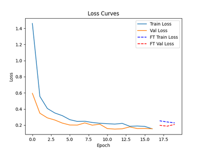

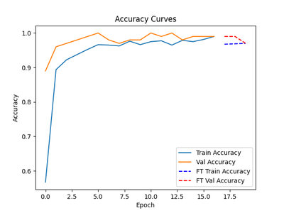

I ran the training script, and to my surprise, the model reached 85% accuracy on the test set on the first try.
I expected way worse. I assumed the dataset was too small. But the model kept improving:
  1. Second run : 87%
  2. Third run : 89%
  3. With fine-tuning : nearly 100% test accuracy
You can see the performance of the last training (with fine-tuning) on the training x validation accuracy and loss curves below. I also added the confusion matrix for reference as well.
That shocked me. I was expecting much worse performance because of the limitations I discussed earlier. I thought I’d need to take hundreds - or thousands - more photos to even approach 80% accuracy. But somehow, it was already doing great.
