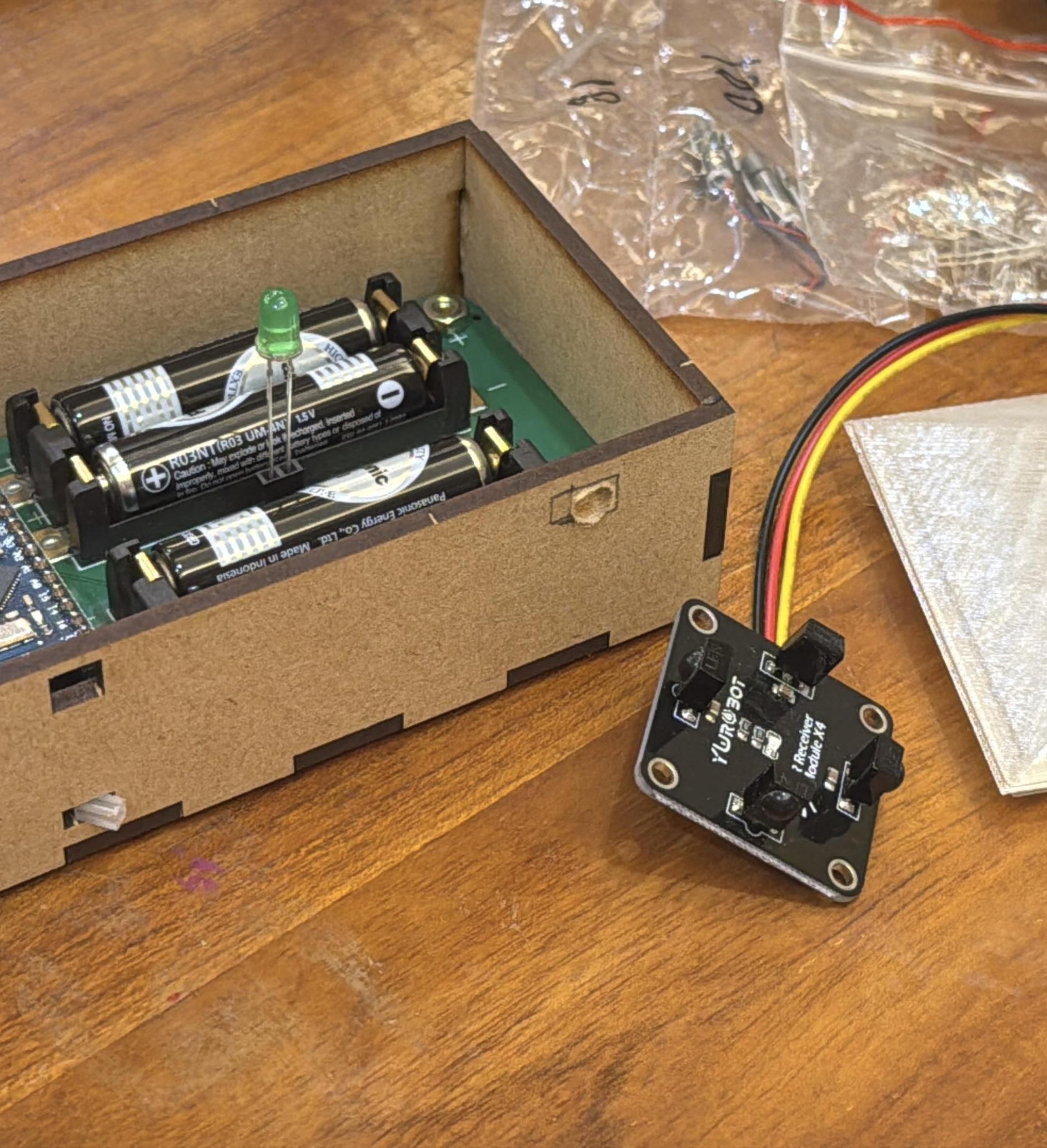

The Training Tying Machine is designed to help elderly people strengthen their grip and knot-tying ability. Users pull the rope within a 60-second session, aiming for at least 30 pulls. For every 5 successful pulls, an additional LED lights up, providing clear feedback and motivation during training.
Tension Sensor
LED
Big Button
Subscribe to 深夜溫牛奶
Step 1: Make Tension Sensor
first of all, we need to tie 2 wire on the rope. and add some coal on the rope.
and we connect the wires to the breadboard, and we repeat 5 times.(make 5)
Step 2: Button
The button is makes cause we need to reset the machine.
button have 2 wires and connect them to the breadboard.
Step 3: The Program
