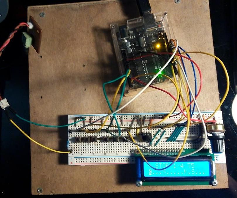

I made this one with Arduino and the MIDI library. It has buttons and knobs for activating filters or effects on Deck A and B
There's also a button to control on which deck each effect can be played (with small leds for feedback) and buttons to control each FX parameter (3 knobs and 3 buttons). To save a bit of space I also made a button to switch between FX A and FX B.

Step 2: Assembling ...
Here is the fritzing schematic :D
