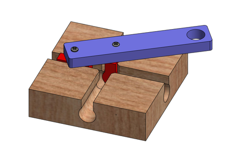

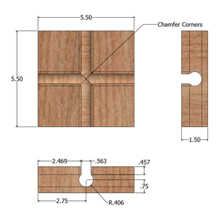

You will be building to this drawing.
Step 3: Base - Step 1
Cut 2x6 to a 5.5” x 5.5” block as shown.
Step 4: Base - Step 2
Mark centers for holes on the sides of the blocks. Use a 13/16" bit to drill the holes through the base. Depending on your drill press travel and the length of your bit, drilling the holes might take a few steps. My low end drill press only has a two inch travel. I used blocks to extend the depth - see video. I also had to drill from both sides. Take your time measuring both sides since this must be a smooth pass.
Step 5: Base - Step 3
The groove was cut using a table saw. Mark the locations for the cross slots as shown on the drawing. Set the blade height to ~ 3/4". Make two passes to remove the slot material. Rotate the part and cut the second slot. To allow for smoother operation, place a slight chamfer on the four inner corners. I did this with a wood rasp file although sandpaper will work.

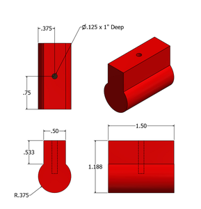

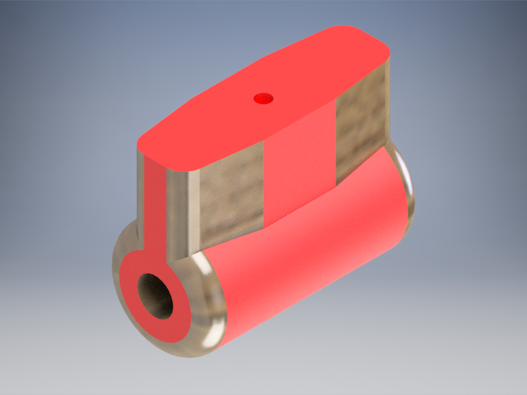

Step 6: Slide - Step 1
Two slides are required for the trammel. The slides are made from two pieces. The first piece is made from a 3/4" dowel. Use a table saw to make a flat section as shown. Although the drawing shows 1.5" long, I suggest cutting this longer (over 3") to make two pieces at once - see video.
Step 7: Slide - Step 2
Cut a 1/2" thick piece of wood as shown. Again, make the length longer than 3".
Step 8: Slide - Step 3
Center the block on the dowel and attach with wood glue. After drying, cut the parts into 1.5" long sections. You might want to round the sharp edges to allow for smoother motion as the slides cross the center section. Drill a hole in the center of the slide assembly. Note that this hole is for a #8 wood screw.

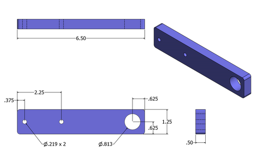

Step 9: Handle
Cut the handle from 1/2" thick wood. Drill the holes as shown. Again, the clearance holes are for a #8 screw. The large hole was cut using the same 13/16" bit from before. Note that a knob (see 3D print) could be used in lieu of the hole.

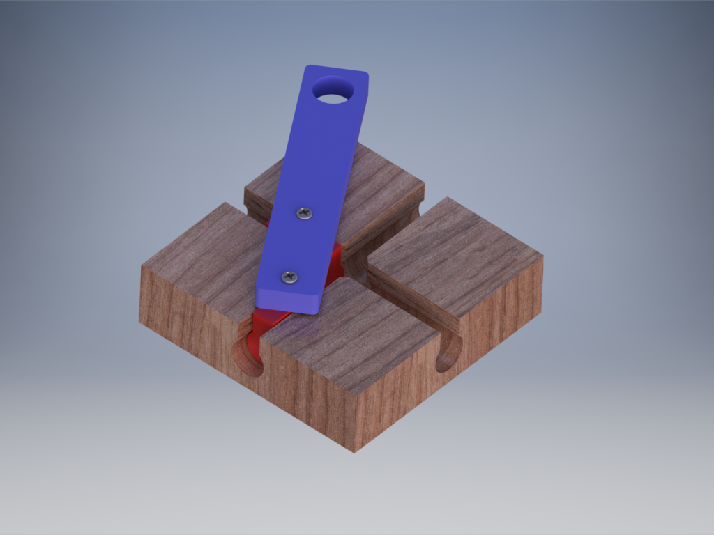

Step 10: Assemble
Attach the handle to the slides with #8 pan heads. This should be a loose fit to allow the slides to pivot around the handle. Try it out. If it binds, use sand paper to open up the slots. Adding rounds/chamfers to the slides also helps keep the trammel on track.
Lesson learned: I tried to jazz it up with paint which turned out to be a mistake. It worked perfectly until I added the paint. The extra thickness and sticky surface caused friction which prevented it from moving easily. I recommend keeping it bare wood or a stain without polyurethane.
