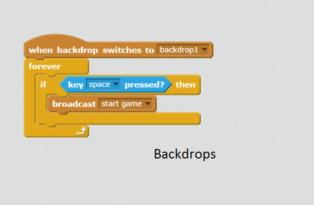

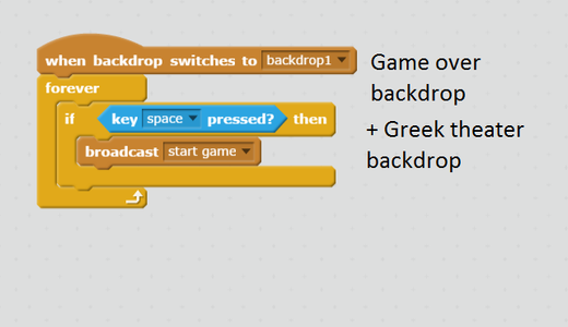

Step 2: Game Setup, Backdrops, and Sprites
The cat, trampoline, and Greek theater background can be found in the default Scratch library. I also made a very simple game over backdrop that says "Press space to restart". When space is pressed, a message will be broadcast to start the game, which sets the cat and trampoline into their default positions.
