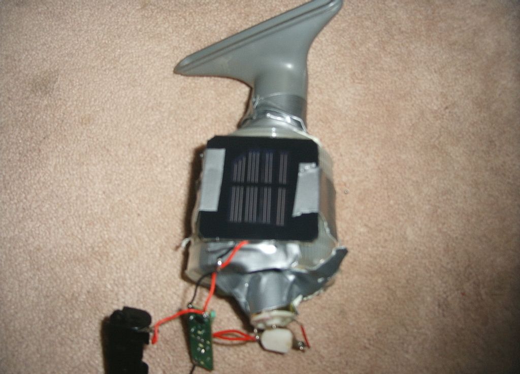

Step 7: Building the Reciever and Using the Device
The reciever is the easiest part. Connect your second mono jack to the solar resistor and battery. You can even place it on the same breadboard, as I have. Just make sure you keep the circuits seperate.
Use:
As stated before, connect an audio source to the first mono jack (the one connected to the laser) and turn the laser on. Connect the other jack to a reciever (such as an amp or the mic. port of your computer) and aim the laser at the solar resistor. The light modulation of the laser are reversed on the reciever and converted back into sound.

Step 8: Alternate Construction and Theory
Instead of using a battery and solar resistor, you could just use a small solar panel. However, these are more expensive and tend to break more easily.
