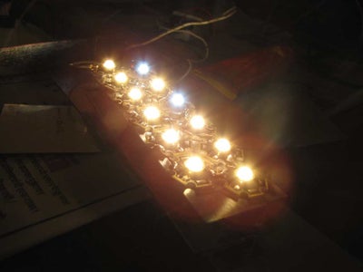

Step 4: Wicked 2800 Lumens of Retina-burning Power!
I pasted 12 of Seoul P4 LEDs onto the aluminium Block.
Each of the LEDs are rated to Deliever 240 Lumens at max power. I used 12...So that wicked 2800 Lumens of Retina-burning power!
LEDs were secured to the block with thermal paste, and a drop of thermal glue.
Be careful about the polarity!
Step 5: 12 LEDs in Place on the Aluminium Block.
SO here is the beastie!
12 LEDs in place on the aluminium block.
Statutory warning-' Do not stare directly into the LEDs, unless you know how to find way without vision or have some replacement eyeballs ready'
