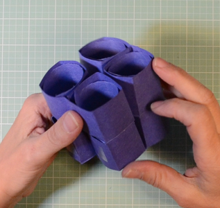

Below are instructions for the most successful construction-paper version, with some notes for other options. You can also watch my video. (I'll come back and insert it here when I figure out how to do that.)
In the photos, the blue/dark one is a "tall cube" and the lighter violet one is a "true cube".

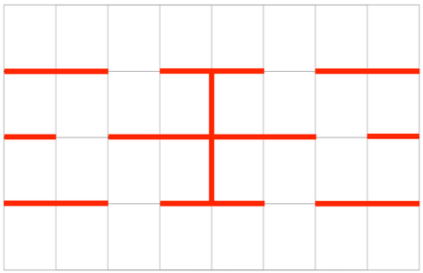

Step 4: Make Seven Cuts
You can just follow the diagram; the cuts are the heavy, red lines. They can be cut in whatever sequence you wish.
Here's one way (again, more detail than you probably need):
  • Use a pencil to mark the parts to be cut (on the back of the paper, if the two sides differ). Follow the diagram. Mark the end of each cut so that you don't cut too far. (I usually don't mark, anymore; I just remember the 1–2–1 and 2–1–2 pattern.)
  • Fold the piece in half so that the short ends match. Notice how three creases cross this fold. Cut along the two outside creases, just a little distance. (Optional, especially if using short scissors: Also cut the middle crease.) You're making slits to fit a blade of the scissors.
  • Open the paper most of the way.
  • Tuck the two outside strips down slightly; see the photo.
  • Put the bottom blade of the scissors into the slit and cut along the center crease, just between the two side-to-side slits. Do not cut the outside strips! If you do cut them, tape them back together neatly. Re-crease them before continuing.
  • From the center slit outward (toward one short end), cut along one box of the first fold, two boxes of the second fold, and one box of the third fold (1–2–1). It's symmetric, so either side can be first. (If you goof and cut 2–1–2 in the center, you can match it, and then cut 1–2–1 into the two outside edges. Make it symmetric, both ways. It'll work; it's just a bit harder to tape.)
  • Repeat this step on the other side, cutting from the center slit toward the other short end: 1–2–1.
  • From one of the short ends, cut along the creases 2–1–2: two boxes along the first fold, one box along the second fold, and two boxes along the third fold.
  • Repeat with the other short end (2–1–2).
Open the paper and check it. If you follow along one of the long folds, it should be cut, then uncut for one box, then cut, then uncut for one box, then cut. The two sides should be mirror images. The top and bottom should be mirror images. The cuts along the center crease should not be quite the same as the cuts along the other two long creases. If that doesn't make sense, compare your cuts to the diagram.

Step 9: Open the Toy and Play
Open each of the eight boxes until the edges form right angles (roughly). If they're stubborn, I take the scissors and slide the (closed) blades along the inside of the tube, then twist gently to open the boxes.
Roll the two tubes toward each other.
Try to fold the ends forward or backward, gently. Either the toy should fold in half, or the two ends should fold toward the center; continue that motion. Then open it the other way. (If it folded in half, the ends should open in a different direction. If the ends folded in, two halves should open in a different direction.)
If a box collapses, keep going with the motion until you can open the box again.
