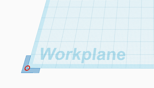

    Before I start drawing I almost always add the ruler. This allows me to make fine adjustments when it comes to placing objects. And we’ll be doing that a lot in this drawing.
    So... Click the “Ruler” and place it on the bottom left part of the workplane.

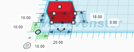

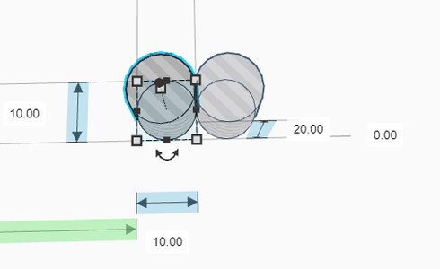

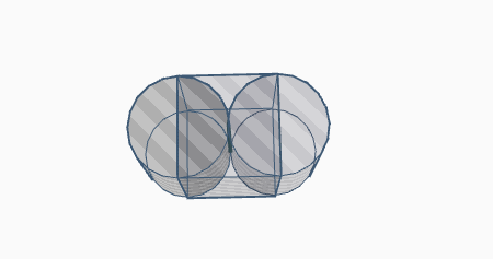

    2: Then we’ll start making the basic shape for the ‘holes’ in our board. We’ll start with two cylinders of 10mm by 10mm that only just touch each other. To add the ‘walls’ in between the two cylinders we’ll drop a box on top and adjust the size to fit perfectly.
    3: Once we have all three shaped we can combine them with the “group” function.

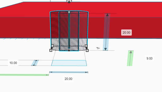

    4: For the ‘holes’ I’ll be going with 10mm by 20mm and a depth of 9mm. (This will be half the height of the ‘walls’ we’ll be making later.
    5: Adjust at what height you want your ‘holes’ to be. For me that’s 9mm off the bottom of the board game.

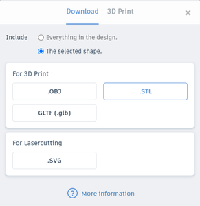

    Final step: Final step is to export everything. Since I'll be exporting the file to 'Luban' - the software used by Snapmaker- I'll be going for STL. STL is in any case a good option since most 3D printers can work with STL-files.

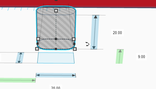

    To design the 'walls' I started with the shape of the 'holes'.
    The only thing different is;
    1. we need a solid form!
    2. I made the pieces 1mm smaller to make sure they fit nicely into the board

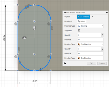

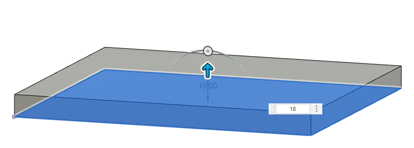

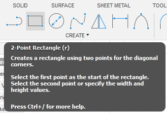

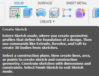

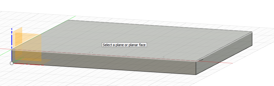

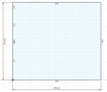

    Just like in Tinkercad we’ll start by making the basic shape of our board. Create a new sketch and make a 2-point rectangle. First click on the horizontal plane to start sketching. I made mine 250mm by 220mm, just like before. Finish the sketch and click on “Extrude” to give the piece some height. I’ll be making this out of birch plywood so I’ll go with 18mm.
    Adding the ‘holes’

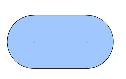

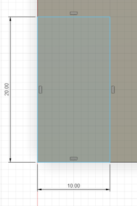

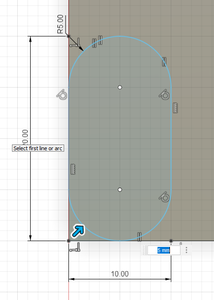

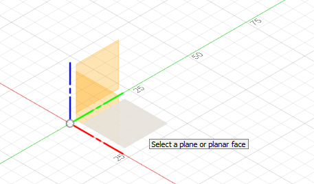

    We’ll start by making a new sketch and 2-point rectangle. When asked for the 'plane' be sure to click on the top of your board to make the rest of the process a little easier. (you'll be drawing on top of your board game)

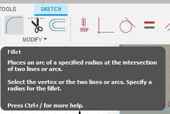

    This time we need them to be 20mm by 10mm. To round over the corners, click the ‘Fillet’ option. Click all four corners and make sure the radius is the same on all four. I went for a 5mm radius.

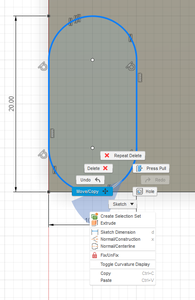

    IMPORTANT for the next step. Remove the constraints, that hold the image locked into place. Look for the small figure shaped like a ‘corner made out of arrows’.
    Move the image to the first location by right clicking and selecting the option move/copy. Just click the little arrows and put in the right distance to move the object.

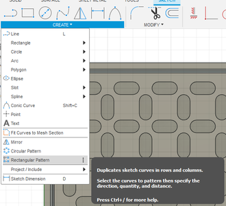

    Once the first object is in the right location we can make our grid/pattern. To quickly make a pattern of these ‘holes’, we can use the ‘Rectangular Pattern’ function. This will come in handy every time we need to do repetitive work. Be sure to change the distance type to 'spacing'.
    REPEAT this process for the horizontal, vertical and round holes.

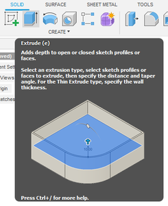

    Extruding the objects to make some holes in our board
    Select all the sketches you’ve just drawn and select the “extrude” option. As in Tinkercad I’ll be going for 9mm deep holes.

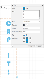

    Adding text

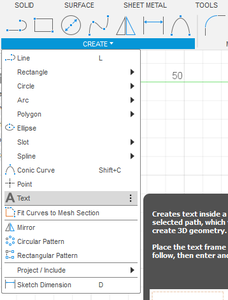

    Under the sketch option there is also the possibility to add text and that’s exactly what we’ll do to spice our board up.
    Again, same thing as in Tinkercad, I’ll be putting the letters underneath each other to make the text run vertically instead of horizontally.I made the depth of the letters 3mm.

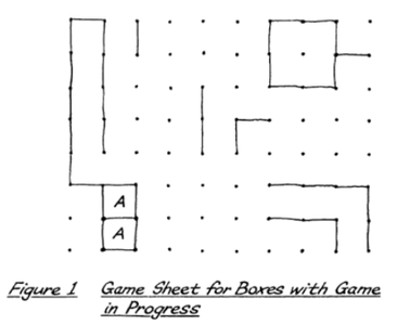

    Each player takes a turn placing one wall. If that wall completes a square that player Captures it (CAP iT!) gets one point and gets to place another wall. The game continues until all the walls have been placed. The player with the most captures wins the game!
    Sounds easy right? Think again!
    The more you play the more tactics you will find!
    For example: How could you possibly win by giving your opponent points?!

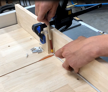

    Cutting aluminium and brass
    For the CNC'd I made some pins out of brass and aluminium. Did you know you can cut those with basic woodworking tools? Even on the table saw!
    TIPS:
    • Take it slow
    • Make sure you hold your piece in place. I used a tablesaw sled and a pencil with an eraser to hold it down safely.
