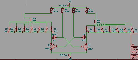

Step 1: Schematic of the Transistor Multivibrator Circuit
This project is built around a classic dual-transistor astable multivibrator circuit. It’s a clever and timeless design that uses the charging and discharging of capacitors along with the gain characteristics of transistors to create a continuous blinking effect.
To understand the theory behind this circuit in detail, check out this excellent resource
Dual Transistor Multivibrator Circuit
In simple terms, this circuit alternates the ON and OFF states of two transistors. As one turns on, the other turns off, causing the connected LEDs to blink in a rhythmic pattern. It’s a beautiful example of how analog components can produce digital-like behavior!

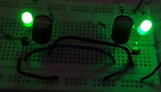

Step 2: Prototyping to Enable Required Functionality
Before diving into the PCB design, it’s essential to verify the core functionality of your circuit using basic components. That’s what this step is all about — making sure your idea works in real life.
What I Did:
  1. I started by building the dual-transistor multivibrator circuit on a breadboard using common NPN transistors (like the 2N3904), resistors, and capacitors.
  2. I tested the LED blinking pattern, ensuring it was rhythmic and visually smooth.
  3. I also measured the voltage and current requirements, which helped me select a suitable Li-Po battery pack for the wearable version and also calculated suitable PCB trace routing and required BMS and Voltage Booster ICs
This is a crucial stage where you can tweak values and experiment with different timings. For instance:
Changing the capacitor value adjusts how long it takes to charge and discharge, which directly affects the LED blink rate.
To make the circuit even more versatile, I added four tiny potentiometers directly on the PCB
2x Potentiometers for LED Brightness. These control the base current to the transistors, allowing you to adjust how bright the LEDs appear, perfect for adapting to ambient lighting or battery-saving modes.
2x Potentiometers for Blinking Frequency. These tweak the RC time constants (resistor-capacitor pairs) in the multivibrator circuit, letting you control how fast or slow the LEDs blink.
You can see the placement and function of these potentiometers in the PCB image notes. Adjusting them gives you real-time control without reprogramming or swapping components!
